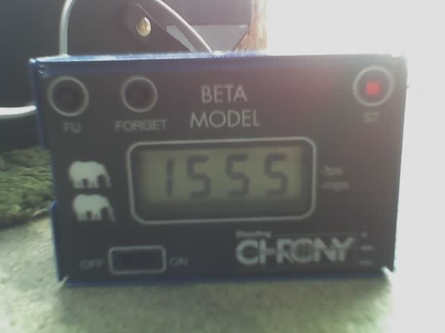

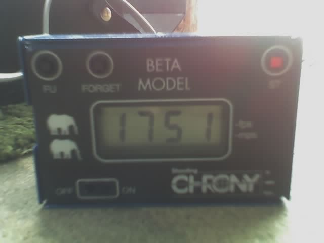

Re: 500 S&W Accuracy
« Reply #6 on: November 12, 2012, 11:40:09 AM »
WELCOME!!
 As the guys mentioned 2-3"are pretty easy to attain with heavy loadings. Mine was best with mid and lo vel lead bullets.
I also shot some heavy weights, I specfically wanted to shoot the Hornady 500g XTP SP bullet.  I got it going better then 1700 fps...  :o
Recoil was stout but shootable.
A better loading in my gun, was a 440g WFNGC bullet with XMP5744 powder at 1500 fps.
CW
