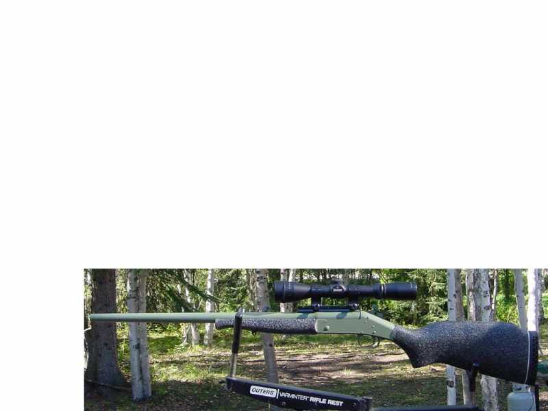

I have to say H&R does a poor job with blueing.  After a few years of use here in Alaska all my Handis look bad.  Especially after being dropped into a river or creek a few times, or tipping the 4-wheeler over in big mud holes with the gun usually on bottom.  So I CAMO them with Rustolium Textured Paint.  Waterproof, non-reflective, with a good gripping surface.  Makes the barrel feel like it has sand in the paint.  Not slippery even with blood on your hands.
That's another reason after cleaning a Moose or Caribou you will have blood on your hands.  handling a gun with bloody hands will kill the blueing.  Blood is very corrosive, and will eat through blueing in no time.  My summer guns are green or brown, my winter guns are white.

I did not use primer, Rustolium has a primer in it, and can be sprayed right over the blueing.  Just make sure all the oil is off.  You can do all the metal with several coats and still have paint left.  I kept the can for touch-up.
Don't know what happened to that picture, it shrunk.

  On most of my guns I do like Sourdough and paint them. The textured paint is wonderful, adding gripping texture and cutting down on reflective surfaces. I use the sand-like texture on the metal and the large grit "Granite" texture on the stocks.
  On my BC I just couldn't bring myself to paint it. So, I use wax. Black Kiwi boot polish on the barrel, Johnson's paste wax on the stocks and action. Rub a thin coat on, let it dry, and buff it off. If I am taking it hunting and don't want any shine I just add another coat and don't buff it out. It's been years since I waxed that rifle and it has yet to show a hint of anything wrong.

OSOK:  That's what I do, textured paint on the metal and Granit Accents Paint on the wood.  Originally I had done the scope as well, but that was three scopes back.

I take the barrel off and put masking tape over the curved surface of the lug.  I remove the scope base, as there sill be oil under it that can not be gotten out with removal of the base.  I also put masking tape over the rear surface of the barrel, where it meets the reciever.  I stuff a cotton ball up the barrel to prevent paint going up the barrel, then remove the cotton ball while paint is wet.  Paint don't last long on the end (crown) of the barrel anyway.  I remove the stock and mask off the interior, and the hammer and trigger to prevent paint from going inside to the internal workings.
