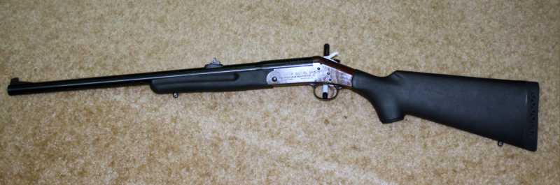

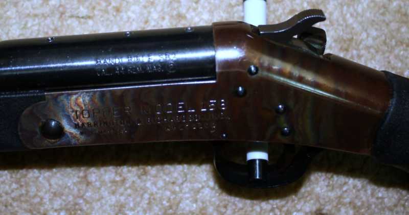

Last Saturday I picked up a rifle Topper frame vintage 1971 for a few bucks. I took it home with the idea that I could hook up one of my lower pressure barrels to it. I tried my 30-30 barrel first, no go, was not even close, bummer. Then I tried my 2007 44 Mag barrel...bingo, fit great. I had a plastic stock and fore end off a previous purchase. Went to put on the stock and there was no stock bolt, great! Went to the hardware the next day to get a 4" 3/8" 24 thread bolt...right. None in sight, bummer again, but wait I could get a 3/8 X 6" coarse thread, bought two and took home. Cut the bolt to 4" and then threaded with a 3/8 X 24 die about an inch, maybe a little less. Smeared on some Never-Seez on the threads and bolted up the stock. I put on the fore arm, grabbed a few 44 mags and headed out the door. Shot it 5 times and it fired five times. Getting there...the frame was rusted up pretty bad, so I worked on it and improved it some. Still debating if I should strip it and put another finish on it or not. When I had it out, I noticed the trigger was a little stiffer than I like. I did a trigger job, much easier to do when there is no blasted transfer bar in the way. I have not run any full power loads through it yet, the five I have were 7.6 grains of Unique under a 245 grain cast bullet. I will have to chronograph them to see what velocity I am getting, maybe this weekend. They shot very well. Standing free, I put two shots right over the top of my 3" spinner at 30 yards, I made an adjustment...dead center. Anyway, I thought I would share a picture of my low budget rifle.

Looks like years of good fun shooting you bought yourself!!
Congrats on a nice rifle!

That looks good.  I've gone the other way an am putting a topper barrel on an SB2, because it locks up so good, along with a 357 & 20ga.  Will be my only multi barrel gun.
But, I'm not sure how to do my new158 trigger and my Huntsman trigger.  Not like the faq guidance because it doesn't have the trigger bar.  Is it the same process?
Didn't someone post about how to refinish the case hardened frame?
Thanks.
When you take it apart, the part that goes between the transfer bar and the trigger is not there and naturally the transfer bar is not there either. The only thing I did was clip the trigger return spring and stone the top of the trigger, per instructions and hammer sear, again per instructions. Went back together real easy. I used a pair on needle nose pliers to squeeze the two legs of the hammer spring together to get them back into the frame. there is not as much tension on them as a newer single leg spring, because it has a rebounding hammer.

I like it very much, going to leave it with irons for now, may add a low scout scope later or a red dot. However, the clean lines and lightness are kind of hard to mess with.
