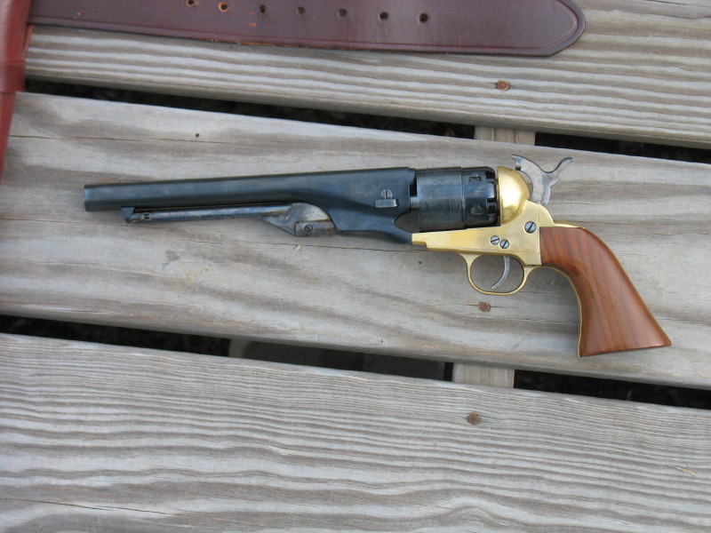

This is my Pietta 1858 Remington Texan with a brass frame along with the holster and ball flask I made for it.  The revolver was a gift from an internet friend of mine.  I spent some time in the Navy so I just had to polish that brass. :)

Nice leather Ironwood. 8)

Ironwood, I like the stitching!  How do you keep it white with black powder soot getting on it?  I  spent time on a tin can, I relate to the polishing brass!  Every time we came into port we would be shining up the turn buckles on the  lifelines....

The Pietta Instruction manual that came with my .44 caliber revolver suggest FFFG black power at 12 grains as a minimum and a max of 15 grains.  A 200 grain bullet failed to go completely through a piece of cardboard at 25 yards with the 15 grain load. :(
Thank you FourBee.  WinterHawk I had made the holster just a short time before I took the photo. :)
