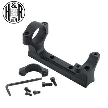

Has anyone tried/used the One piece H&R scope mount ?  H & R 1 Piece Integral Scope Mount

Looks allot like the dednutz mounts.
If so they are VERY well made. But also quite tall for
many peoples tastes.  Self included.
I do have a set of the Dednutz mounts on one maxi barrel. As I said its well made just too tall.

Many people use the DNZ mounts... including myself... they are very solid... but as CW said, they can be high, depending on your scope objective... The H&R mount is made by DNZ (GameReaper)... they currently only make high and xtra high versions... I wish they made a medium height mount also for some of my compact hunting scopes... here is one on an Ultra .243 with a Mueller APV 4.5-14X40mm scope;

I've got two on two different H&R rifles and really like them a lot.  As the other guys said they are solid and very well made. They are high depending on the objective lens size you have and come in 1 inch or 30mm ring size. One I have is on a scope with a 56mm lens and I'm glad it is as high as it is. Talley also makes a 1 piece mount which I have on another H&R and it's a extra high also but they are not quite as tall and the clearance for the trigger makes me nervous sometimes, more trigger clearance with the DNZ GR. I'm not sure what the high version is like where trigger clearance is concerned.
