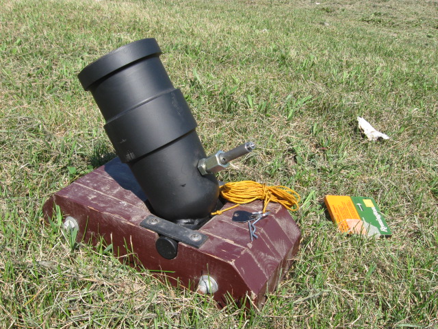

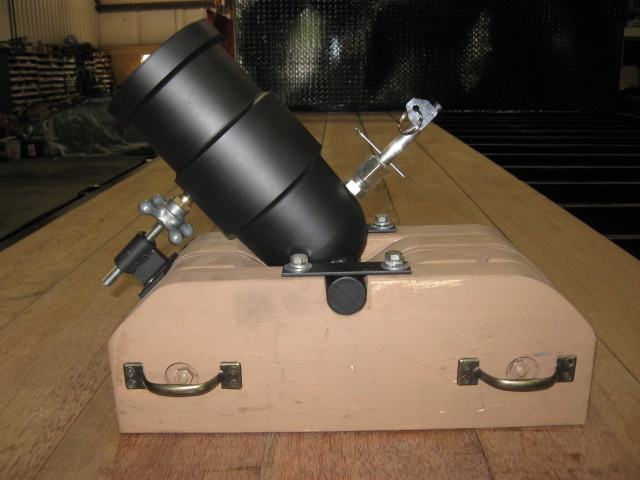

Here is a look at my new firing system . This is the prototype mounted on a BC mortar .

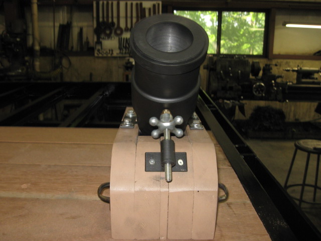

This also shows how to mount an elevation screw on a bed that was not designed for one

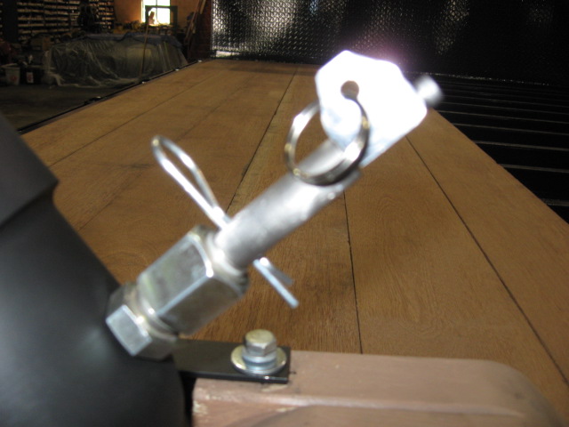

And a bit more detail on the firing mech. itself . Uses 209 shotgun primers . Simple inline striker . A lot of off the shelf parts . I expect several refinements in the near future .
It has a hair trigger , almost too light , hence the positive safety pin .  I will test fire this week end . Smoke & fire to come .  ;D  Armorer77

The elevation screw is 3/8-16 threaded rod . The handle is a faucet handle tapped to 3/8-16 with an acorn nut . The mount was made by welding 2 pieces of 3/16 by 1 1/4" angle back to back . This was cut and milled to the desired .800" height .  I then cut a light groove with a ball end mill to assure the alignment . The barrel is a piece of 3/4" drilled & tapped 3/8-16 . All but 1/2" of the thread was cut away to a clearance .
Jeff is moving tomorrow so the final test of the new ignitor will be late in the day .  It has already entered it's third modification . All I have done so far is pop primers . "Sometimes you gotta build one , to find out what you don't know . " Ed

Test firing success .
Let's see if this works . I have some stills of the loading process . Ed

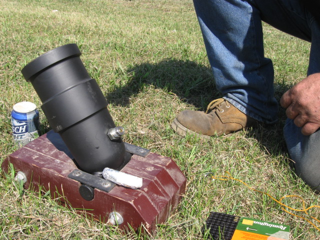

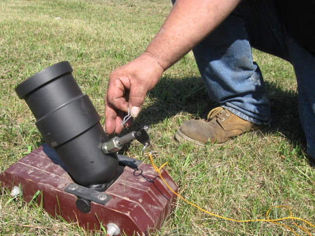

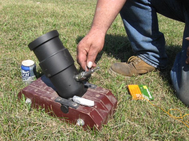

Loading , Use 209 shotgun primers
First install Safety Pin .
Unscrew and insert primer and reinstall .
Install trigger , remove Safety pin .
Fire .  ;D ;D

Notice the can of operator lube to left ;D 8) :o ;D 8) :o ;D 8) :o ;D ;D ;D ;D ;D ;D ;D ;D

Look a little closer . That is the ammo .
