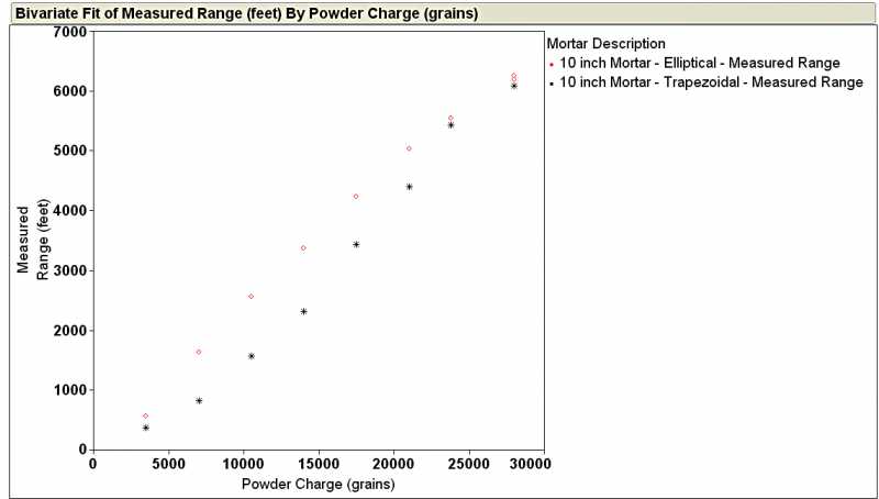

If I read this right, elliptical is more efficient out to about 1 mile.
Re: 10 inch mortar ellipitical vs trapzoidal powder chambers on range
« Reply #2 on: August 13, 2012, 02:47:25 PM »
One mortar with two chambers or two right-much similar mortars?
Eight different charges.  One shot per round or several shots averaged?
Offline Parrott-Cannon
  • Posts: 215
« Reply #3 on: August 13, 2012, 03:45:54 PM »
Good questions.Two mortars were use with different chamber configurations.  The report pointed out that the elliptical chamber shape increased the bore length by three inches.  Five shots were made from each mortar at each powder charge the range reported was an average.  Unfortunately the individual data for each shot was not reported.  The shape of the curves my be more important than the difference.  It appears that the elliptical shape causes a more efficient burning of the BP, while at lower load densities the trapezoidal chamber shape is less efficient.  I have been trying to model mortar internal ballistics for over two years and have found a similar pattern at full load density the model works but as the load density decreases the model over predicts the muzzle velocity.  A cylindrical chamber shape that is used in many of the reproduction Coehorn mortars produces an convex velocity versus powder charge curve.  Velocity and range are closely related

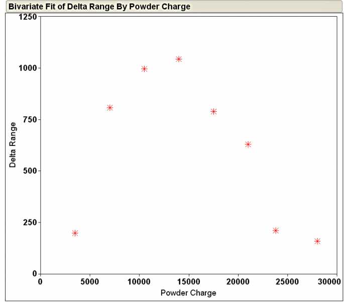

Barrel length has a impact on velocity.  But it by itself does not explain the data.  The graph below is for the relative difference between the two mortars.  If velocity dur to barrel length were the controling factor the graph would be a near linear function.

I always prefer the experimental approach but I do not have the equipment to do the experiment you propose but I do agree your approach is a good one.  I would use ball of different weight because the mass if the ball also impacts the muzzle velocity.
