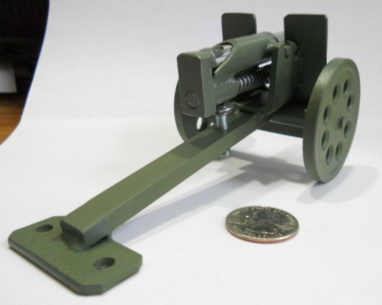

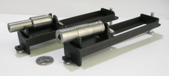

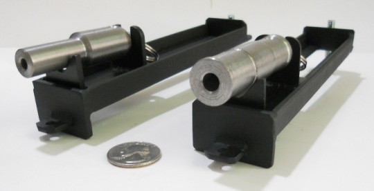

I've built quite a few micro cannons in the past year.  They're lots of fun to build.  I posted a few photos below.
This first model is a 25 caliber breechloader.  It fires the .250" daisey slingshot BB's.  I gave this one to my brother.  I think he's pretty well hooked on the cannon thing. [My fault  ;D ] He get a free cannon every time I visit.
Here's a WWI BB cannon with a recoiling barrel assembly.  Fun to shoot.
And these are the cannon barrel key chains with stand and front pivot barbette carriage I have listed on my website.  They are available in either 3/16" bore for the .177" BB or pellet or 1/4" bore for the Daisey slingshot ammo.  The barrel is small enough to carry on a key chain.  It recoils when fired on the barbette carriage which has a rear elevation screw for sighting targets.

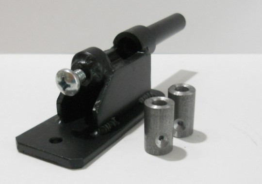

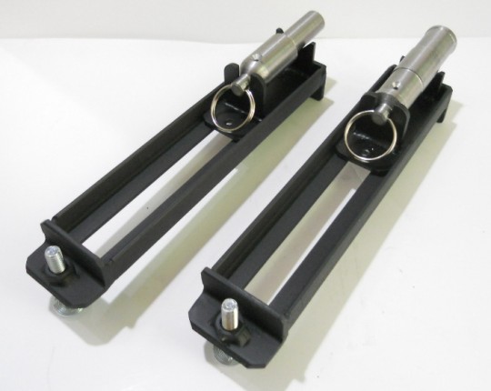

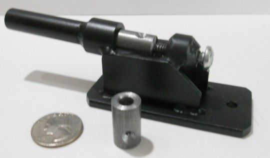

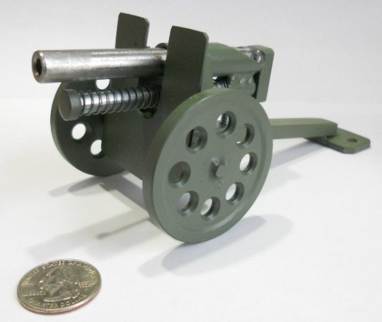

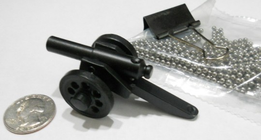

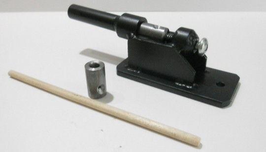

    I hope these 5 pics will possibly inspire someone to make one of these tiny, simple and fun artillery pieces in miniature.  I never finished the 24 Pdr. Flank Howitzer, but the tube lays in a drawer waiting for a bit more time than we have had these past few years.
Tracy
I made the Rodman BB cal cannon and the Flank Howie tube using a temporary, homemade lathe.  You don't really need a pair of calipers, but the plastic ones they sell for reloaders are $5, so get a pair.  Diameter measurements are so much easier to accomplish this way.  Add a hacksaw too and a std. propane torch.
Following a sketch, with a file remove what you don't need for the final product.  Go slowly, checking the diameters as you go. When all the dimensions have been filed take out your hardwood mini sanding blocks that you made and sand 120, 180, 240 and 320 grit for a normal finish or 400 grit for a brite one.
Don't forget the details like the slight reduction in dia. where the first reinforce meets the chase.  Chase ring too and the muzzle band.
Polished to about 240 grit, ( wet and dry paper ).
These two paper disks are called "Sight Gages" and are used in this case for positioning the automatic prick punch in exactly the right place for marking where to drill the holes for trunnion pockets and also the vent.  A glance will tell you that the upper one locates the trunnion pockets and the lower is guided by lines on the upper so you mark the vent's position precisely along a line perpendicular to the co-axis of the trunnions.

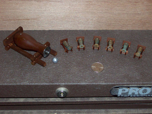

Here is one of my favorite pics of all time.  This BB mortar is a replica of those wooden mortars built by both sides during the Civil War in 6 and 12 Pdr. sizes  I think the wood was red gum, but someone could correct me on that. Mortar by Lance and photo by CW, I think.

The bore is 0.285. The finish on the steel was done by first rusting the surface with acid vapors, then painting with rust converting primer to create a black wrought Iron look.
The Larger container contains FFFF black powder and the smaller container 1.5 inch lengths of 1/16" fuse. The powder measure is a .22 long rifle casing.
Most of the wood came from scrap pallets which are a convenient source of 1/2" thick white oak stock.
