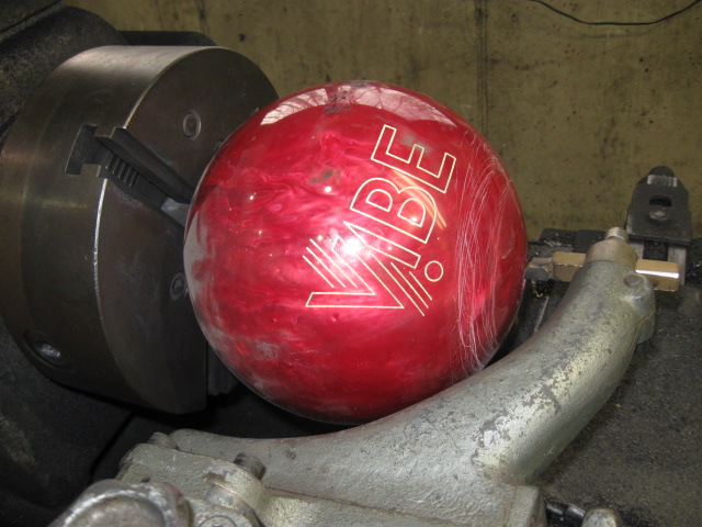

Since this topic seems to be of interest or amusement I will post the rest of the pics .

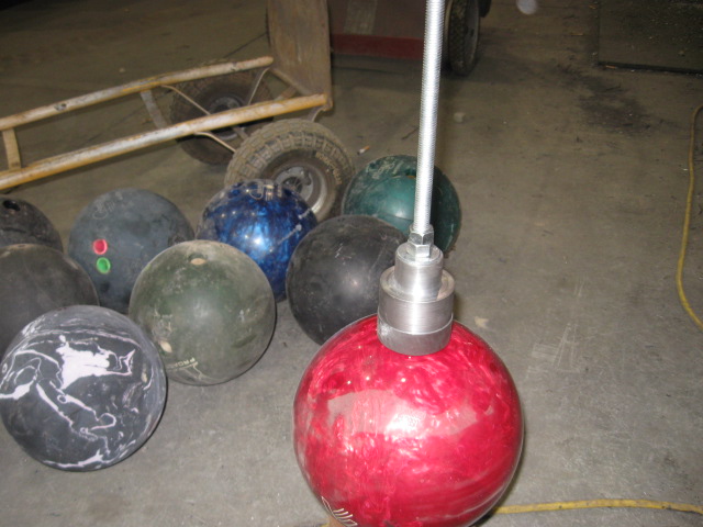

The first question was how to hold it . The answer , install a draw bar .

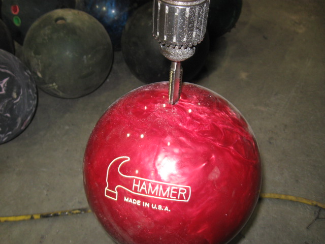

Frst , drill & tap for 1/2-13
The draw bar with a centering collar ready to go . The rod reaches through the headstock and is retained with a big washer and nut .

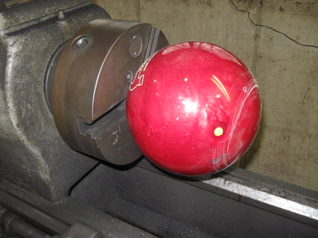

As you can see , the jaws are useless in this application .

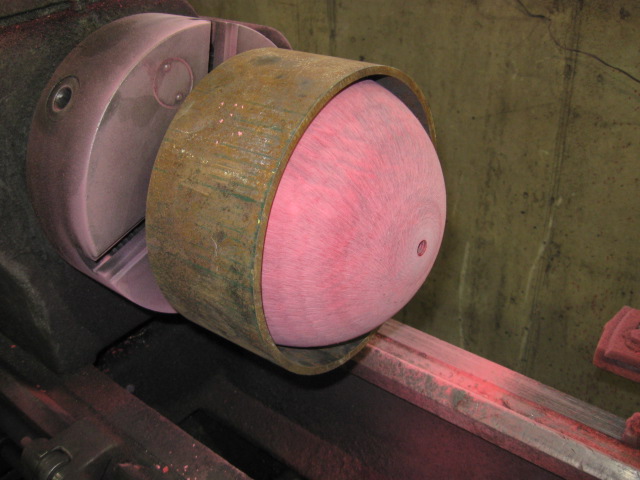

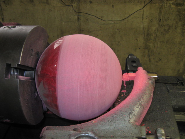

Ready for the first cut.
1st cut complete .
Drill & tap for the other side .
Passes guage , I did 11 balls in about 11 hours . Armorer77

armorer,
How did you know you were centered and straight on the first drill and tap?
Offline armorer77
  • Posts: 541
Re: How to turn a Bowling Ball
« Reply #2 on: June 24, 2012, 10:15:05 AM »
A good eye , and years of practice . Also the centering jig got me close enough . Ed

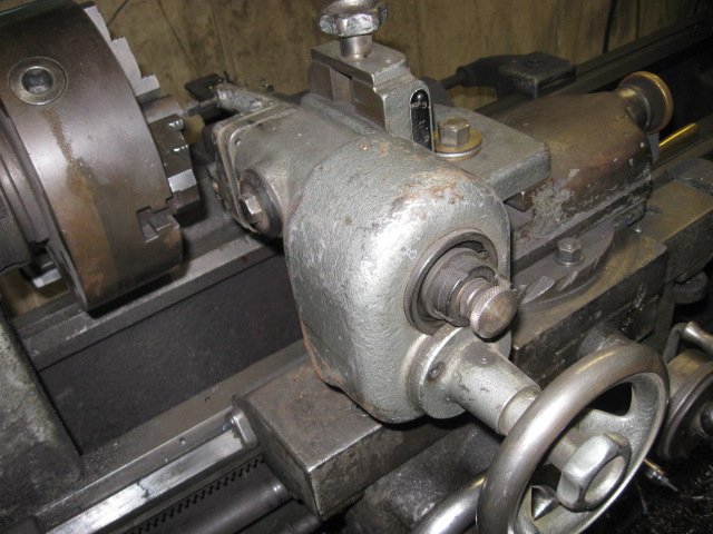

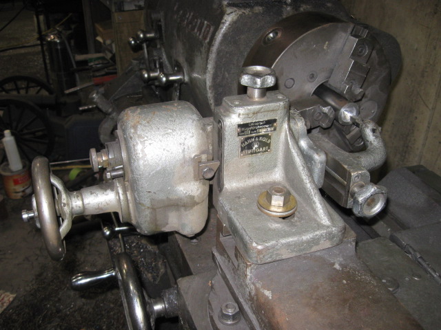

Now GOW , here the pictures of my radius cutter you wanted .
Here shown set up to cut a 1.23" ball mold . The tool is German , and so is the only manual available . Armorer77

« Reply #5 on: June 25, 2012, 01:37:25 PM »
Now THAT is a radius cutter!

« Reply #6 on: June 25, 2012, 01:54:38 PM »
I wish I knew what I was looking at. ??? ??? ??? ??? ???

« Reply #7 on: June 25, 2012, 04:48:23 PM »
IF someone wants to compare... google Holdridge Radius Cutter and you can see a wanna-be of the tool Ed has.  I am drooling with envy  :P
armorer77:
Thanks for the pics and info.  I knew there had to be a better version than the Holdridge...
GOW

« Reply #8 on: June 25, 2012, 09:58:02 PM »
The only flaws to this tool are the graduation lines are ,008" and the only owners manual is in German . Ed
