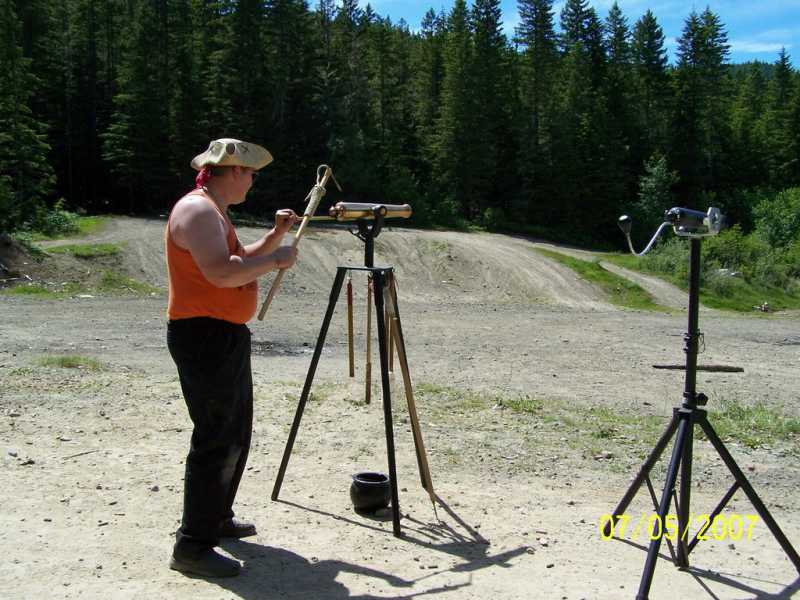

Hey, that's Tropico with his swivel guns! Didn't Dominick or Powder keg make the base on the left?

I  was  interested in  something strong and light weight I could easily assemble with no nuts and bolts to lose. Gravity holds this together pretty good and portability was (is) a must. The legs are just under 1 1/2" O.D.  The leg sleeves welded to the 3/8's plate has a 1 1/2" I.D.  The  sleeves are 6" long and cut and welded at 22 1/2 degrees . The 48" long legs give a 36" triangle spread on the ground . We welded some Chain-Links halved to the plate for tool hangers. We recieved a swivel base and welded pipe from Dominick with our Swivel yoke Dom built for me.  This is the same pipe used on our tripod. This provides no play and is smooth. Re-coil on a 1" bore with a lead projo is less than you may think and is easily controlled with my tripod. I am happy and confident with my tripod. The system easily can move left-right or up-down so one has to be steady ., hitting reasonably sized targets is a trick but fun.  Good luck and please keep us posted on whatever you come up with. I enjoy the learning.
I did have a hook welded to the bottom also. This hook is for a bucket i keep water in. (No ., recoil doesnt soak me)
Also we have used the tripod for cooking over a fire ., as well as melting  lead in a plumbers pot. Always camp with your swivel.
