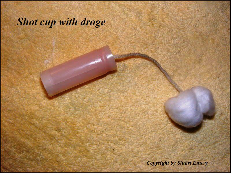

It doesn't hurt the rifling any, might lead it some.  It's pretty useless past 6 foot though and already donuts by that time.  I did some testing earlier this year using the Speer Shot capsules in my .45 LC Classic Carbine and it was pretty stinky by 6'.  With my black hawk (shorter rifling, so less spin?) I can get out to about 10 foot with minor donuting.  I did see a version of a shotcup with a droge (looks like a woman's product) that they use to shoot shot from Forsythe rifled firearms.  I have been thinking about trying something similar with the .45-70 and a tail with a light load using steel shot cups for a .410 to see if I can get the droge to stop the spin somewhat.  If it works, might make it worth packing a few along.  Might even be able to recover the droge and reuse it.  8)

« Reply #12 on: May 02, 2012, 03:03:59 PM »
Yep I make these now for my Blackhawk.  8)
