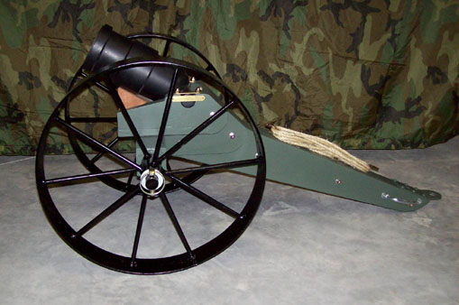

Here is the progress on a project I have been working on since the weather has been keeping me indoors.  I aquired one of HMR cannon's pop can mortars and after seeing how Dominick had put one on wheels just knew I had to try that.  I won a bid for a pair of 18 inch wheels for $27.00 and designed the rest of the carriage around that.  Cut and glued some scrap plywood together and just need to add the rest of the hardware and paint.  The block holding the mortar at elevation in the photo is temporary.  I made some blocks that easily attach and remove for 0,5,10,15,22.5,30 and 45 degree angles of elevation.  Hope to have this ready by the time warmer weather arrives.  Will post some video then.

Finished the mortar project and hope the weather will let me test fire this weekend.  Will post video soon.  The block system that holds the elevation at various angle works well.  Shown with the 30 degree block.  I also will be making a standard bed for this mortar and working on some wood wheels for this carriage as I think it would look better.

« Reply #9 on: April 27, 2012, 02:45:57 PM »
Looks good! How well do you think the axle will stand up to shooting the mortar at higher elevations?

« Reply #10 on: April 27, 2012, 04:07:16 PM »
Really don't know.  The axle is a beam constructed of 3/4" plywood formed tightly around a 1" solid steel rod.  The mortar chamber will hold about 390 grains of BP at the most.  How much that would push on the axle is to be seen.  I will hardly ever use a full load as I only have a 200 yd range to shoot at home.
