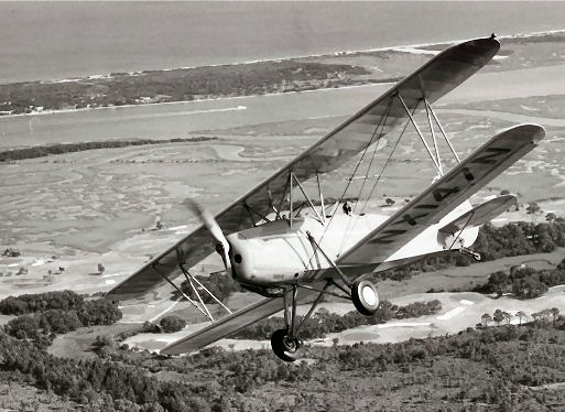

   One of Powel Crosley's (see WLW in Entertainment Section) many interests was in aviation. For several years the Crosley Corporation built airplanes under the auspices of the Crosley Aircraft Corporation. The 93 acre airfield was located where the Ford Motor Company's Sharonville Transmission Plant stood. Crosley built monoplanes and biplanes like the one pictured below. In addition to this venture Crosley joined with Julius Fleischmann to start the Metal Aircraft Co., in 1928,  at Lunken airfield. They each put up more than $100,000 to become vice-presidents of the Company. They then started to manufacture a series of all-metal aircraft called the "Flamingo." you can see the plane above. Now that they were building the plane they needed to create a market for the Flamingo so they started an airline. They called it the Mason Dixon Air Lines in June of 1929 with daily service to Detroit. They were all set for major expansions when they suddenly sold the whole enterprise, everything,  in October, 1929--just days before the stock market crash. Obviously they knew something was going to happen. Powel maintained his interest in aviation and continued building Moonbeams but, soon, that business also faded away. There is still one Flamingo flying today in South America. Through a series of mergers, the company that bought the Mason Dixon Air Lines went on to become American Airlines.
Crosley Moonbeam.jpg (51909 bytes)                                    Crosley-Lunken.jpg (116507 bytes)
               Moonbeam biplane                                    Mason & Dixon Air Lines
