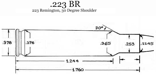

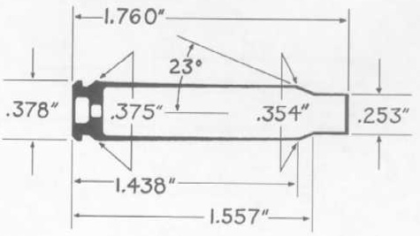

Is this a fireforming proposition?
« on: April 10, 2012, 07:15:10 PM »
223 Rem
Offline Nobade
  • Posts: 1927
Re: Is this a fireforming proposition?
« Reply #1 on: April 11, 2012, 01:53:06 AM »
Have to use a full length die to set the shoulder back and establish headspace and then fireform to blow the body out.
That thing is going to have a very long neck!
Why not just shoot a .222?

Thanks for the prep info. Cheap brass, and you never now what we may be able to accomplish with long necks and heavy bullets.

Hillbill: Have not made any decisions on bullet weights and powder and twist yet.
With the really long neck, as the powder capacity is probably about 88% of a 22BR, the .570 BC 90gr JLK (that makes for the ultimate 22BR long-range load) would be fun to try in a nice slow twist of 1:7 or 1:8.
