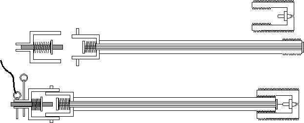

OK how about plan G for a firing mech.
This would use a percussion cap on the nipple that's seated in the head of the gizmo at the right.
The head would screw onto a firing pin section, the long tube, and then would be inserted and screwed into the bottom of the powder chamber.
Then the hammer section would be attached which has two pins, a safety and a release.  It attaches to the mid section like a tail light bulb in a car.
When ready to go you'd attach the hammer section to the back of the firing pin section and when ready to fire the safety pin would be removed.
Then pull the rope to the release and BOOM.
This is a rough sketch to get the mechanics of the thing down on paper and will need a redesign since it'd be a pain if the head stuck in the chamber and the firing pin section unscrewed leaving the head behind.

Last night right after I made my post above, my modem/router died. This morning I worked my east and then south from one radio shack and computer shop to another ending  108 miles away at  Wal mart where I finally found one.   Got home by 3 and was back on line  by 4.
Again I like your though process...clever design for a firing mechanism.  Probably work too, except...  since you want to put the vent in the end of the tube, you will have to reach under the tube and insert the charged mechanism upwards under handed into its seat. Ever had to reach under something and screw a bolt in  a hole.   It's awkward and probably hazardous. You won't be able to see the seat to align the mechanism.  Also as you work the mechanism into its seat the combination of vibration and gravity could and probably will cause the cap to fall off the nipple.
Will be much happier with a conventional location.

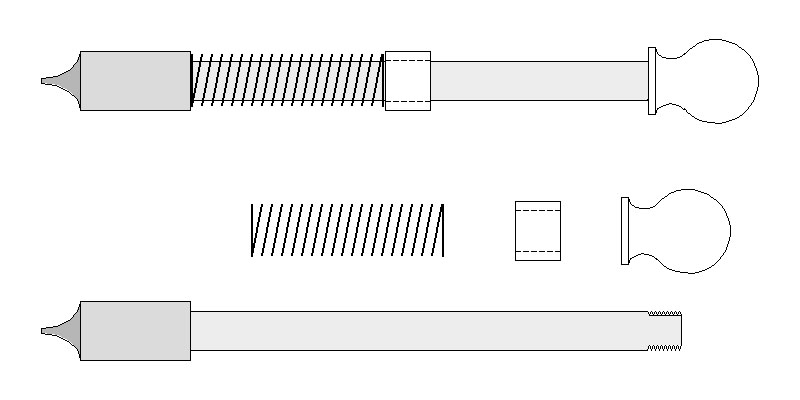

That's beautiful.  Is this how it works?
Offline Max Caliber
  • Posts: 524
Re: Mortar tube design question
« Reply #41 on: March 02, 2012, 08:58:53 AM »
holychrome, you hit it right on the nose.
Max
