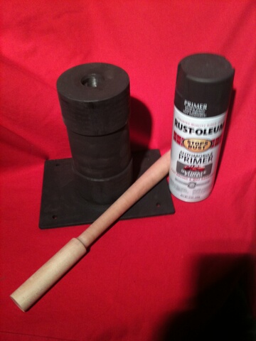

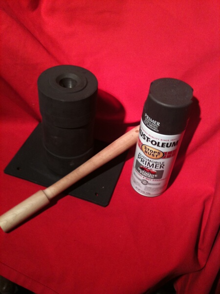

Having seen WAY too many of these on Ebay, I have decided to offer some WAY over engineered thunder mugs. I am using 3.5" stock, 1" bore and the minimum OD is 3.25". In my blurb I was thinking of mentioning that some of the "Signaling Cannon" offered are nothing but pipe bombs waiting to happen, but I think my blurb will be "My over engineering is your safety" It will be on a base 5.5"x7.5" base that I plug weld on with 5 3/8" plug welds.

These are turned from 3.5" stock, max OD is approximately 3.4", minimum is  3.25". Bore is 1". 1/8" fuse vent is 1.5" from the bottom of a 7" tube. A 5.5x7.5" base plate is plug welded to the bottom with five 3/8" plug welds. My answer to the pipe bombs on Ebay.

« Reply #17 on: February 29, 2012, 01:07:16 PM »
Good answer.
