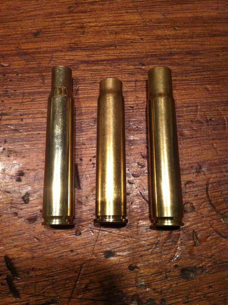

Re: Could someone please test an idea for me?
« Reply #13 on: February 19, 2012, 09:23:52 AM »
Has anyone tried necking a 405 Win down to 35 Whelen ? The brass is available and a lot cheaper than the 7X65R. It is a few thousandths smaller at the base but it might work after fire forming.
Here ya go, 405 Win case is .458" at the case head vs .463" for the Rem Whelen, 2.587" long, neck diameter is .383"  with bullet seated. There's a slight difference in shoulder position because my 35 Whelen die is set up for forming 35 Whelen Improved.
That is interesting and would be a simple make-up
Many thanks to you for making up these cases and posting the pictures.
I really like the size of the rim on that 405.
Guess we should call that a 35-R Whelen imp ?
Otter Bob
« Reply #15 on: February 19, 2012, 01:20:00 PM »
Otter Bob
Sure, once it's fireformed any way!!  ;)
