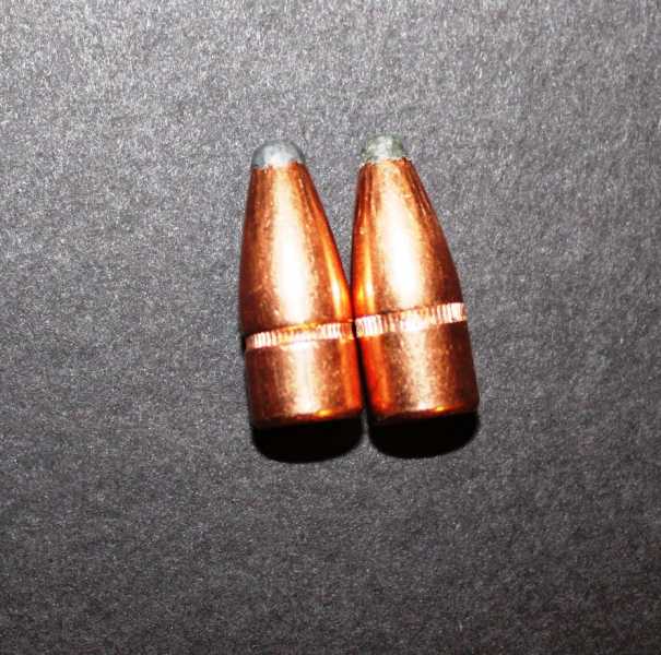

The picture shows two different bullets that are labeled as the same brand and model - Hornady #3505. Clearly they're not the same though. I have no doubt that they may be the same model number but is it normal to have this much variance? They are not from the same box.
Thanks, Dinny

Re: Bullet Variances
« Reply #5 on: January 24, 2012, 08:52:03 AM »
Did you weigh them both and measure both?
Is the cannelure in a different place but both measure the same length?
The one on the right looks chubbier :-*
Different lot #s?
Boxes look the same or one older, diff. from other?
Maybe you have found a collectable :-\ ;D
Load five of each and see what they do. Good luck ;)

« Reply #11 on: January 26, 2012, 12:11:44 AM »
Thanks, Dinny
Dinny,
 what is the age of the bullets? I mean is one box appreciably older then the other?
The profile is different, the OAL is different, the placement of the cannalure is different AND the actual cannalure width is different too. This is NOT the same bullet!
Is this the only one of is the whole box the same... err different... err ::) you know what I mean. ;)

« Reply #12 on: January 26, 2012, 03:49:06 PM »
CW,
  Aging them is difficult. The one that is in the original box may be a few years old. It's not in the newest box design, but the next newest one. The other bullet came from a recent deal I made and is repackaged in a plastic box. In each box, all the bullets match each other. Does someone else make another bullet similar in design to the Hornady 180gr SS-PB? Maybe Hornady made one that was slightly different years ago?
It's definitely not a Speer 180gr FP. I have some of those too and they aren't even close.
Thanks, Dinny

« Reply #16 on: January 26, 2012, 11:29:59 PM »
I was going to ask if these might be reboxed "seconds"... If so about anything is possible as its out fo the manufacturers hands.
I would not even bother calling the factory, they likely came thru Midway. I have bought these bullets too and nearly every box has something funky inside! Why, just last week in a box of 86G 25-20 bullets had a FMJ 86g "looking" bullet!! LOL I am not certin but consider these cheap bullets "seconds"...

« Reply #17 on: January 27, 2012, 01:12:48 PM »
CW,
  That's a good point you make. I never was even thinking about "seconds". I bet you're right!
