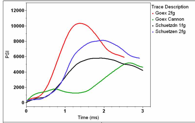

« on: October 12, 2012, 12:42:42 PM »
These pressure were measured in a 24 inch rifled barrel with 120 grains of each powder firing a 250 grain 50 cal. bullet.  The data provides an interesting comparison of 3 different granulations and powder from two different manufactures.
The energy released based on pressure:
2570 ft-lb for the Goex 2fg - 2.52 ms - projectile exit time
2272 ft-lb for Schuetzen 2fg - 2.92 ms - projectile exit time
619 ft-lb for the Goex Cannon - 3 ms - projectile exit greater than 3 ms
1399 ft-lb for Schuetzen 1fg - 3 ms - projectile exit greater than 3 ms

Very interesting stats.  The often stated idea that the velocity from cannon and 1F is close or equal even though the pressure is not, cannot be shown by this data because it only shows that the time is an unknown amount greater than 3 ms on each of these.  They are also different powders (manufacturers).
Re: Pressure Producted by Different Powdwes
« Reply #6 on: October 14, 2012, 03:16:22 PM »
Perhaps Parrot cannon can explain it better.
But is looks like to me that Fg is developing higher pressure faster, and has virtually the same  velocity as Cannon grade when it leaves the barrel.

First the projectile is seated on top of the powder and the ignition plug also takes up space so the distance traveled is the effective barrel length or in this case 1.667 feet.  For the Goex 2f, using your suggested calculation, a velocity of 661 fps is obtained (1.667/0.00252 seconds).
The correct basic calculation are:
acceleration = (Pc*Area)/Pm
velocity (Vi)=acceleration*time - Time = 0.0001 seconds for the pressure interval
Total Velocity = sum(Vi) in this case the Pressure Trace II records 300 pressure data points.  So there are 300 Vi that are added together to get the total velocity or muzzle velocity.  For the Goex 2fg example the peojectile exited the barrel at 2.52 ms so 252 data points were used in the velocity calculation.
Pc - Space Mean Pressure - Friction Pressure do to air drag and projectile friction with the barrel
Area - the area of the base of the projectile
Pm - the mass of the projectile
These equation are simplified from the actual calculations but are correct in principle.

Time of travel over a set distance is the average velocity.  If you travel 5 miles at 30 miles per hour and then 5 miles at 60 miles per hour.  The time of travel is 0.25 hours or an average velocity of 40 miles per hour.  Velocity is a vector so direction can also part of the equation.  However in this case velocity and speed are the same.  I will assure you that the projectile moved a measured distance of 1.667 feet.
The shape of the pressure curve is a function of the powder burning rate, which is pressure dependent, and the amount of gas generated during the burn.  It is also impacted by the amount of solids produced because this reduces the volume in which the gas expands.

For those who think high pressure is the answer to velocity examine the pressure curves for thr Goex and Schuetzen 2 fg powders.  The Goex powder has a much higher pressure than the Schuetzen but the Schuetzen powder maintains its pressure for a longer peroid resulting in only a 4% lower velocity.  Most black powder arms produce about a 7% variability in velocity in a shot string.

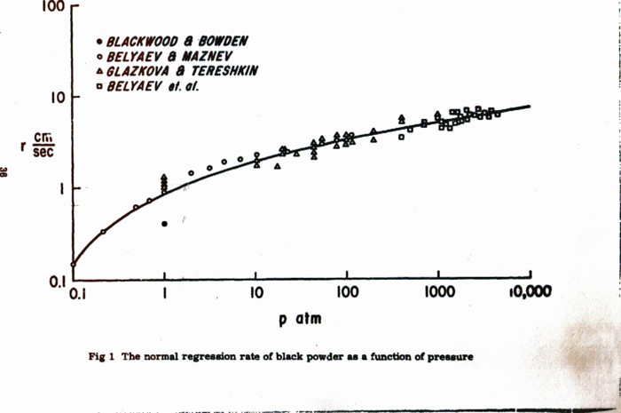

« Reply #27 on: October 17, 2012, 03:22:25 PM »
The burn rate graph shows how the burn rate changes with pressure:
Notice how the burn rate is expoential to about 5 atm and then becomes linear.

No luck with my friend - he's a soil scientist and the best he had was "Well, I heard this guy from Aberdeen give a talk once..."
This post got me interested in chamber pressure measurements in general.  Maybe everyone else is familiar with the concept, but I found an article with a good description of a DIY setup:
http://www.ktgunsmith.com/straingauge.htm
andy
