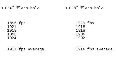

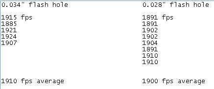

[size=78%]My flash hole is drilled to .035 but, be that as it may, a larger volume of hot gas thru a constant size hole means a flame with more velocity and longer duration. Shoot a W209 primer at nite and you can see flame come out of the muzzle. The seat of my pants tell me that the longer flame duration transfers more heat to a powder that's harder to light than black or traditional black substitutes. I do know one thing for sure, even below 20 degrees,  I get instant ignition indistinguishable from a centerfire rifle.[/size]
As mentioned before, the flash hole in the breech plugs used in my rifle are always 0.028" until they become  larger, because of the erosion from the shooting.  My rifles have been tested extensively for reliable ignition of BH209 powder in sub-zero weather.  This testing has proven to me that a 0.035" flash hole is not necessary.
One definite disadvantage of the 0.035" flash hole is a simple thing.  When one drill the flash hole larger, one just then aged their breech plug a few hundred shots, and what was a new plug, is now hundreds of shots old.
The other day, i shot my rifle through a chronograph, so to compare speeds using two different size flash hole.  The flash hole size was changed between each shot.  How this was done is by removing the breech plug, and switching vent liner with the different size flash hole.  Then the next day i did the same test again.  The following two charts show the result of these shooting.
One can see the differences in speeds is negligible i.e. flash hole size isn't critical in determining how the powder ignite.
It seems the chronograph is telling us the smaller flash hole allows as much flame to reach the powder as the larger flash hole.   Then the question becomes, how does the smaller flash hole transfer as much heat to the powder as the larger flash hole.  The answer is provided by Bernoulli' Principle which is demonstated in the following link.
http://mitchellscience.com/bernoulli_principle_animation
The load shot through the clock was 270g Deep Curl, 110g BH209, green harvester sabot, and STS primer.  Rifle was an Accura V2; the QRBP allowed for easily removal, and re-install with different vent liner.  The chronograph was placed about 15 yard out; wasn't in exactly the same place on the two different days.

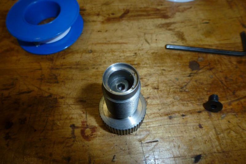

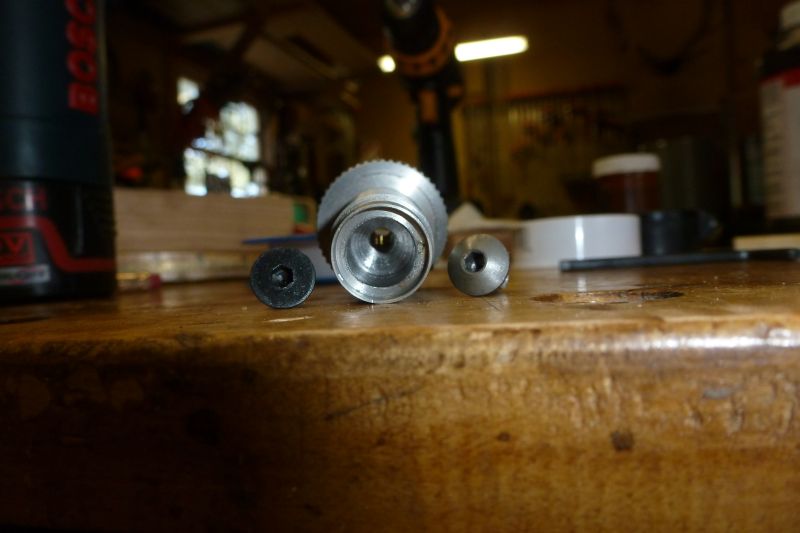

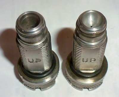

My intent was to show that the smaller flash hole produced virtually the same speeds as the larger flash hole. To me this indicates the powder burn was the same, regardless of flash hole size.  To me this indicate that the heat transferred through the flash hole was virtually the same, regardless of diameter.
Another thing that i wished to address, is drilling out the flash hole to 0.035" from the factory size of 0.029" essentially takes a brand new breech plug, and turns it into a breech plug with hundreds of shots through it.  Drilling the flash hole to 0.035" virtually makes a brand new breech plug old and worn out.
It could very well be that i am incorrect, but i believe the breech plug in your rifle is very nearly the same as the Triumph breech plug.  Following is what can be done to a Triumph plug, to cure a problem with ignition delay.
First thing was to drill all the way through the plug with a 5/32" drill.  Then the chamber on the powder end was drilled some deeper with a 5/16" drill, and about 7 threads were made with a 10-32 tap, after the taper of the hole is made steeper using an 82 degree countersink.  This allows for the 'vent liner' to be used to replace the flash hole.  The vent liner is simply a 3/8" long 10-32 cap screw with a 0.028" hole drilled through it.
Here is a photo of the modified plug next to the factory Triumph plug.
The modified plug has never produced a delay in sub-zero weather using a vent liner with a 0.028" flash hole, and when the flash hole in the vent liner wears so it is larger than 0.035", it can simply be replaced with another vent liner.  For some reason, it seems that making the 'powder chamber' a little deeper cures the ignition delay.
This just illustrates another way to cope with ignition issues whilst using BH209 powder.

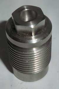

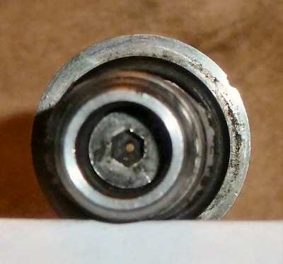

Ron,
Your breechplug looks quite a bit different than mine. I think my whole plug is shorter than just the threaded portion of yours. I'm glad you found a solution to your hang fire problem and I'm even gladder I found a solution to mine. As to my breechplug being worn out, my Encore groups 3 inches @ 200 yards with zero blowby, so I guess I can highly reccommend a worn out breechplug.
Ed
Offline ronlaughlin
  • Posts: 7
Re: Bighorn 209 & 25acp ignition
« Reply #16 on: January 16, 2012, 04:06:25 AM »
Oops, wrong plug.  It was an incorrect assumption on my part.  I assume you are using the plug shown here.
The dimensions of the new CVA plug made for shooting BH209 are virtually the same as the dimensions of the TC plug shown here.  The flash hole is the same; 0.029".  The flame channel diameter the same; 1/8".  The length of the flame channel is near the same in the two plug.  My point is the CVA plug designed specifically  to ignite BH209 is dimensionally the same as the pictured plug.  I, myself, use this plug in my Omega(s).  It has never failed to ignite BH without delay in just about every imaginable condition.
Your plug is working good for you.  That is good!  It is good when we shooters are happy.  However, your plug is hundreds of shots older than an unaltered plug. It is my understanding, Western Powders considers this plug to be the 'best' factory plug to use with their powder.
