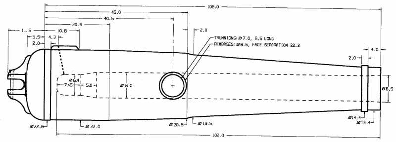

According to the book "The Big Guns, Civil War Siege, Seacoast, and Naval Cannon"  by Olmstead, Stark, and Tucker the second pattern 8 inch shell chambered shell gun of 63 cwt was described as having a nominal length of 106 inches, weight ratio, 110.3 with round shot, bore length, 12.8 calibers in early tubes cast between 1841-1843.
There were four patterns of this gun.  There are no drawings for the first and third patterns.  Your drawing is very close to the second pattern.  The only noticeable difference is that the muzzle ring on the original is closer to the muzzle.

« Reply #3 on: December 30, 2011, 03:47:45 PM »
The image below was taken from "The Big Guns".  Jeff I don't have any information about which gun might have been the type specified in the orders.  Hope this drawing is helpful.

     Jeff,    I believe you have selected a real classic cannon to re-create.  I have been interested in that model ever since seeing one on the terraplein of Fort Macon near Morehead City, NC.   In 1862 the Rebel artillerymen chased the Federal Gunboats Gemsbok and Chippewa back and forth as they tried in vain to hit the fort.  I have read that this gun scored two hits on these ships during the battle.  The chop was so bad on the ocean on April 25th that the naval gunners didn't have much of a chance!
     I see Artilleryman beat me to it, but note the caption below for a hint on how to tweak it just a bit to become an 8 inch instead of a 10.
Good Luck!
Tracy
See how the base ring is just a little bit bigger than the cylinder forward of it?  Dia. 22.6" VS 22.0".  It only protrudes .3" whereas the 10" gun has it a full 1/2" above the surrounding metal.  They recently installed the new replica made of cast iron.  The one we saw in 2004 was fiberglass, but very well done and the size is impressive.  Make yours as large as you can within reason; it will look better!

Thanks for the plans Artilleryman. It looks like there was a bit more to it than simply scaling the 10" gun to 106". I updated my drawing to conform to yours.
That's a good picture of the cascabel Tracy. I wasn't quite sure how wide those flat reinforcement pieces were from the drawing. This would make a good candidate for a large cannon since it seems fairly uncommon compared to the normal Civil War guns. But I'm staying at 1:28 scale to compare it to my IX Dahlgren. I've documented my great great grandfather would have either manned or been in close proximity to at least 8 different cannons and I'd like to make a set all in the same scale.

« Reply #6 on: December 31, 2011, 03:19:17 PM »
One of the things that I found interesting about the drawing I posted is a 1/2 inch flare in the bore diameter at the muzzle.  I have to assume that it was put in to assist in the loading process.
