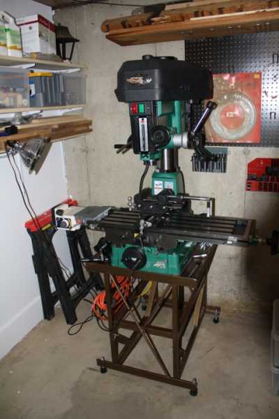

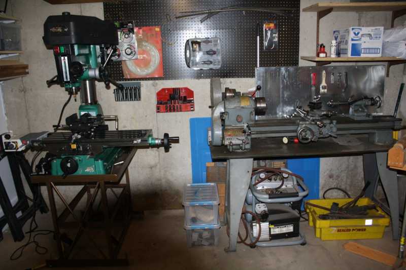

I now have a small mill with a 32" X 9" table (23 1/2" X 7" travel) with power feed from Grizzly. I welded up the mill stand with a Hobart 140 MIG welder that I acquired a while back. The Lathe is a South Bend 10K with a 4 1/2' bed. I have some basic tooling for both. I do want to get an index table for the mill and a follow rest for the 10K. I will be able to do some small gunsmith jobs for myself. I am not interested in doing anything for any one else, just a hobby for myself. I am kinda pumped about getting my shop to a point of being able to most anything I want to do.

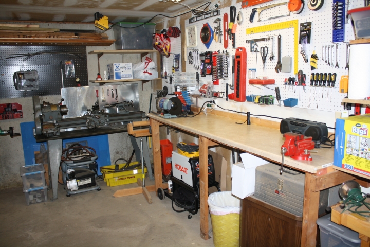

AtlLaw - you sure have a way with words ;D Here is another picture of the shop.... er garage
A better picture of the stand and mill

Not sure about who's welding is better. That stand is my first project. The first time building something. Up to this point, I just did repairs. I just lay on a lot of weld and grind it down, give it a coat or two of paint. ::) I am thinking very strongly about making a trailer for my 25 HP diesel utility tractor.
Miller welders are good. In fact I think my Hobart is a Miller under the skin. The welding handle that came with mine says Miller on it! ;)
I have since wired the Mill for 220v and added some heavy duty casters to it. That is so I can roll it out or back to get it out of the way easily. I am thinking about doing the same for the Lathe, the casters that is. The ol' shop is shaping up ;D

i strongly recommend making your mill level before doing any work with it.

« Reply #12 on: November 06, 2011, 11:10:53 PM »
Thank You for the advice. I do have leveling "feet" on the stand I built. Since this picture was taken, I have replaced the leveling bolts/rubber cups with double casters that are lockable and adjustable for leveling, enclosed the stand and added a storage shelf. I also leveled the lathe before I turned it on. It had no provisions for leveling when I got it. I seriously doubt it was ever leveled from the day it was bought in 1972.
The power feed on the mill is really slick for long cuts. When I have a long cut to make, I just set the feed rate, adjust the cutter height, table position and turn it on. It travels through the work piece very easily. If I have to stop at a certain place, I adjust the stop so it quits, just short and finish by hand.

« Reply #13 on: November 07, 2011, 11:07:01 AM »
I just took an updated picture of the Mill. I have rewired it for 220 Volts, enclosed the stand, added adjustable/lockable caster wheels. I ran 220 to the back wall and jumped off 4 - 110 plug-ins to run the power feed and extra lighting. Not shown in the picture, I have also added a 6" rotary table with dividing plates and a tail stock to my fixture assortment. I think I am pretty well done with it. It sure makes working on it a pleasure. Before I re-wired it for 220, it would dim the lights in the house, every time it started up (it would pull 19 amps). That is no more now ;D .
