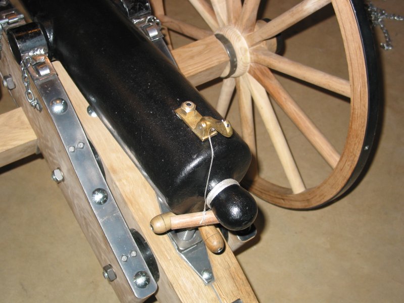

This is my first post, hope it works.
First of all I would like to say how much I enjoy this forum. You are my kind of folks. Great information and ideas for a hobby I have been interested in since my dad gave me the BP cannon his father made him in 1930's.

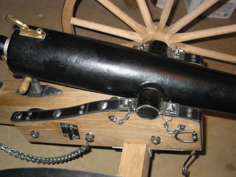

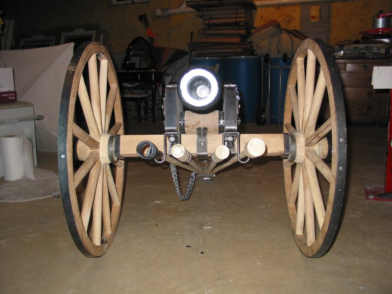

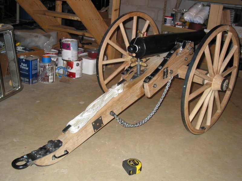

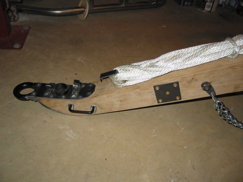

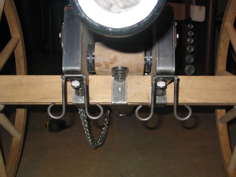

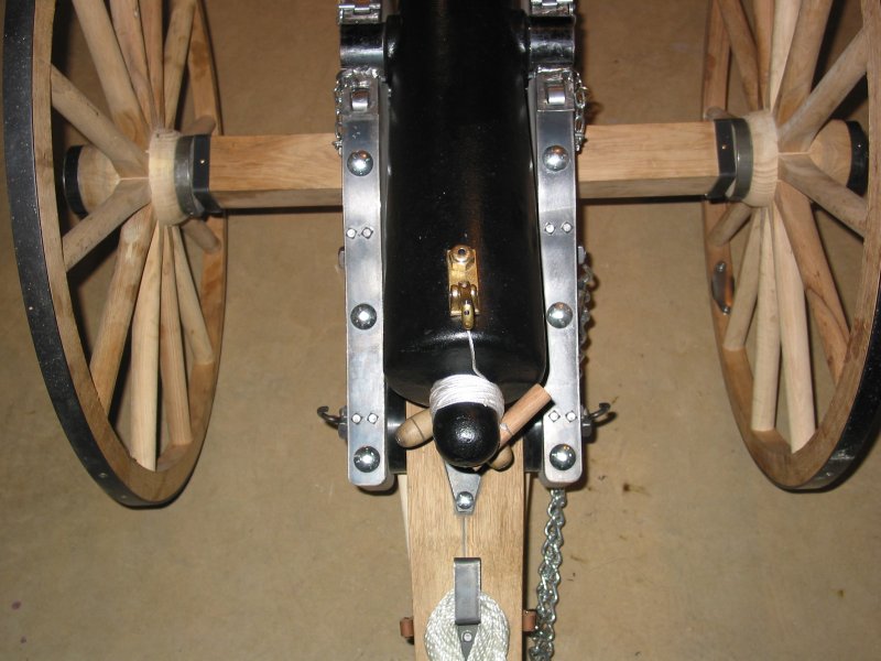

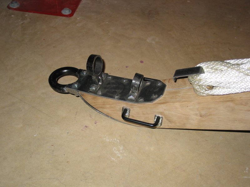

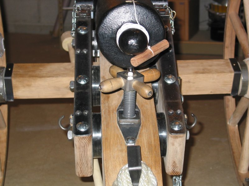

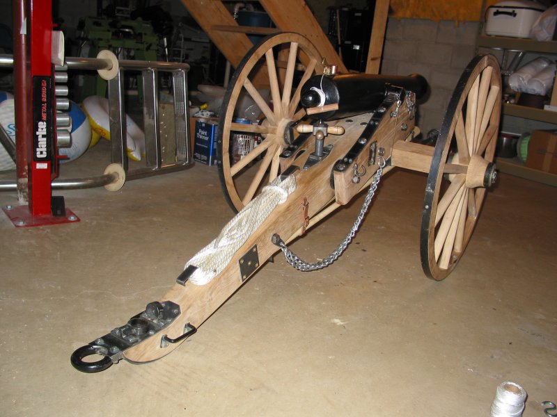

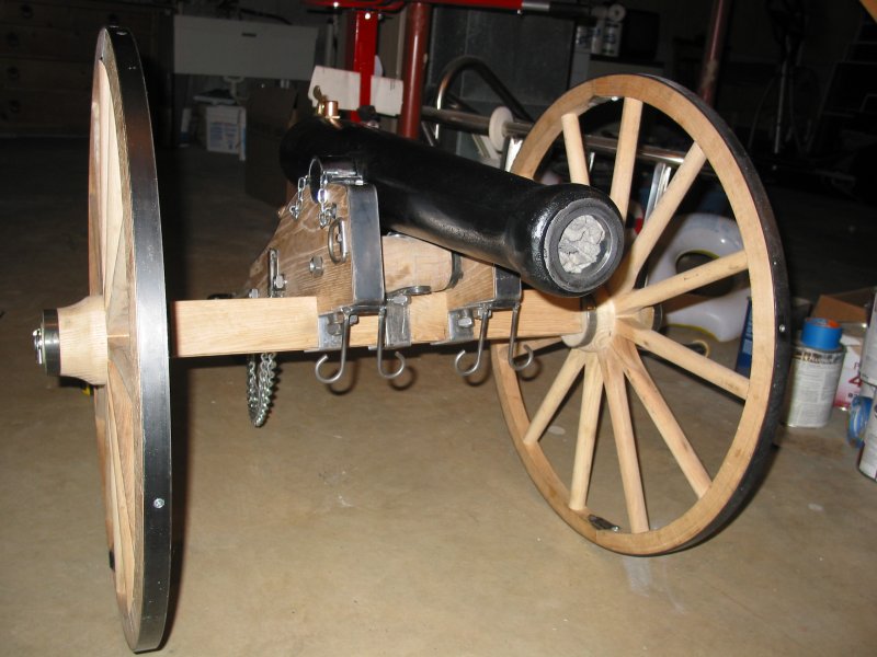

I have built a 1/2 scale Napoleon and just finished the last parts last night, thought I would let you folks take a look and critique my work. It is a 1/2 scale napoleon on a traditional Civil war era #1 carriage. I built everything except the wheels (Amish), the Tube (Hern), the Lock and worm. Here are some pictures:
All that is left now is to take it all appart and apply the finish.
What do you think?

Welcome to the site! your Napoleon looks great! You've done a great job on the carraige,
So how soon till we see some smoke & fire photos?
  ;D
Re: Finished 1/2 Scale Napoeon
« Reply #2 on: January 26, 2009, 04:17:19 AM »
     Looks like all your effort paid off!  Very nice indeed.  The wood to metal fit looks excellent.  What sort of plans did you go by?  Will you be firing projectiles or blanks from the Napoleon?

I need to find an appropriate location to fire some billiard balls (proper back stop). Mostly I fire blanks (make noise). I scaled the plans for the carriage from picture in a book I found on the Net.
It was fun to build, but took a long time.
I have two sons so I told them when I die they will have to share it. Maybe I will build another some day and hope my two daughters have no interest in cannons. Can't possibly see myself making four.

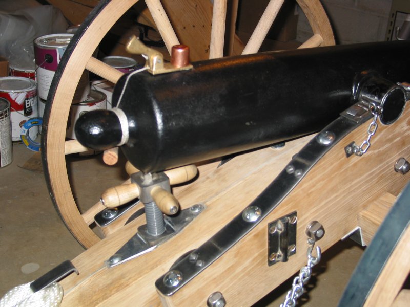

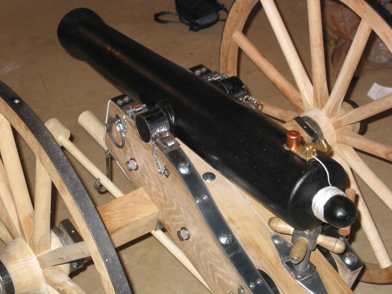

I know legal rulings are something that is avoided here, but just opinion then. Does anyone see an issue of me using the Lock with firing pin and 209 primer for ignition. It work great and makes the gun safer in my opinion, but do you think it is OK legally?
« Reply #14 on: January 27, 2009, 05:02:47 AM »
No legal response needed.  Primer ignition was used pre 1899 so it is not an issue. Bigger issue is the 209 primer close enough tothe powder charge to ignite it.   How heavy is your gun, you might want to consider friction primers.
Offline tesavis
  • Posts: 10
« Reply #15 on: January 27, 2009, 05:13:22 AM »
Seems to be very reliable. The tube is your standard Hern 1/2 scale napoleon. The diameter at the breach is 5.5". with a 2.325" bore (good windage for billiard balls). so the wall thickness including the liner is approximately 1.59". I have a vent liner made from 7/16" threaded brass rod. The vent liner has a 1/8" hole bored the length. I use the brass acorn nut for the primer pocket and it also retains the lock. This allows me to make different ignition solutions (fuse vent, lock ??) and swap them in with no additional holes in the gun tube, works great.
