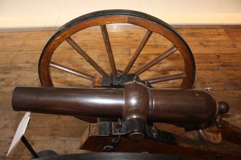

     Looks like this tube has more 'Blakely Gun' features than 'Lyle Gun' features.  The prominent, applied Trunnion Band of the Blakely field guns is evident.  We am not aware of any that large on Lyle guns.  The squared off Cascabel of the Blakely Guns at Fort Pulaski near Savannah, Georgia is on this tube as well.  Also the weight compensation feature of a reduction near the muzzle is evident.  This was noted on a Blakely field gun supplied to the South during the Civil War in the CaptainBlakely.org website.  In that instance, an applied ring was placed on the tube in the area of the Chase to compensate for Breech heaviness.
     We are not aware of any Blakely guns this small, but these similarities are interesting even if it is NOT one.  There was one 2.1 inch Blakely gun made for Peru in 1861, but it was rifled.  It is thanks to our wanderings all over the country and to the exellent Blakely Gun website here:  http://captainblakely.org/FirstManufacture.aspx   that we have this info, even if it proves not to be pertinent.  It is fun to speculate.  Hope we hear from Starr 2011 on this one.
Mike and Tracy
The square Blakely Cascabel can be seen on the Pulaski Guns; there are two here.  Our photo.

Side by side:
From Checkpoint Charlie's
From the OP.
Looks pretty close except for the muzzle reduction.

 Just to confirm that Zulu’s gun isn’t a Blakely. It’s smooth-bored. It looks to be entirely cast iron. It hasn’t got a breech band (obviously unnecessary for a smooth-bore), it hasn’t any breech or trunnion markings, but it has a muzzle stamp, which is unknown on Blakely guns.
I am sure that, as everyone else has said, it’s a Coston Lyle life-saving gun.
I admit to getting excited that it might have been one of the CS Texan Blakely’s reported in the OR. But it would indeed make a nice “Blakely” mountain gun.
