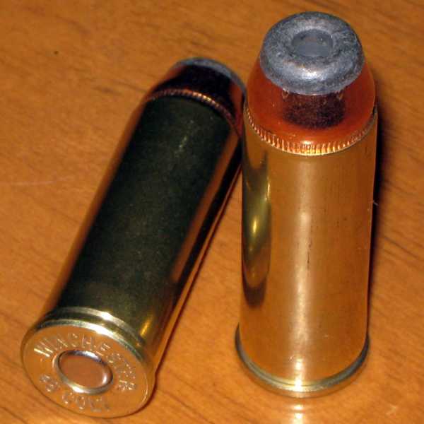

.45 LC bullet change-up.
« on: October 29, 2011, 07:38:13 PM »
Tried a couple sets of a new bullet today and had pretty good luck.  Sierra 240gr. Sportsmaster JHC is the bullet.  Using 10 gr. Unique in my 5.5" blackhawk.  I picked up a mixed bag of .45 bullets from a guy getting out of loading due to physical ailments and this was one that looked pretty cool.  Punches good holes in paper so far, so I loaded up 20 of em tonight.  May try some water jugs next, as I think I'll be using this in the blackhawk opening day of deer.  ;)
