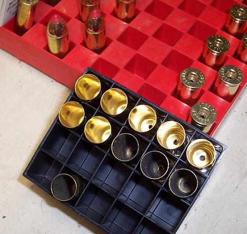

The one I got from Harbor Freight works well for me too. I like using the vinegar mix first if dealing with a heavy carbon build up and then finish with the BC mixture. These 2x fired.45 Colt were cleaned with the BC mix only. Like Tim, the number of cases I clean at one time is minimal. I use Ball canning jars instead of the beakers.  ;)
Bill
