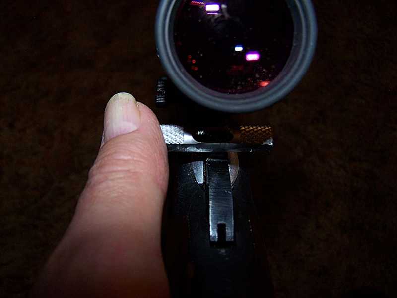

I have had no issues with the hammer extinction on my 336.
Quote from earlier post.
"I shoot from the right and left side.  I replaced the one sided hammer extinction on my 336 with one designed for the Thompson Contender.  I had to file it down on the lower side to gain proper clearance.  I did this at the time I replaced the 4X Weaver with the 2x7-35MM Burris.  I can safely cock the hammer with the two side extension and return it to the half cock position.  Burris scope shown."
I have fired close to two hundred rounds since the installation, the primary ammunition has been full power handloads but I have also fired commercial Remington, Winchester, Federal, and Hornady.  I think that is a few more rounds on the high side then most people put through their 336.  The only screw I have had to tighten was the front barrel band.  Admittedly the recoil from my 30-30 is mild compared to the 45-70.
I cannot recall if I used Loc-Tite but if I did it was the blue.
I just put the rifle away for this year but I will be sure and check the extension the next time the rifle is out.
