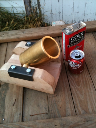

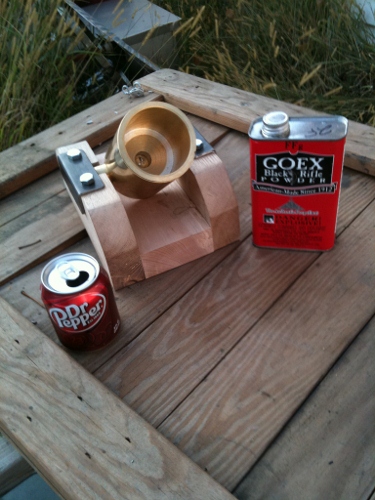

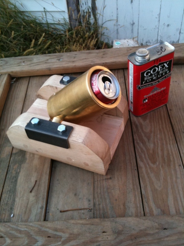

So I ended up with a piece of brass wide enough for a can mortar, but not long enough, so I designated it as a tennis ball/short can mortar. I am able to get 8 oz cans of soda, they will be filled with concrete.

 :) Looks pretty interesting to me...  Like to see shots of it firing, and what your range is with those concrete filled 8 oz cans...BoomLover

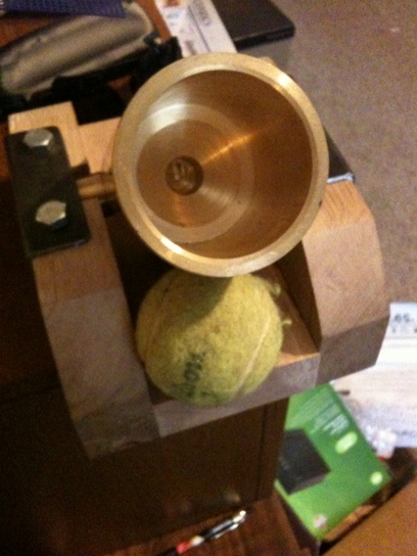

It has a smallish, by my standard, powder chamber. Only 3/4" X 1 1/4" so I imagine using FFFg probably about 100 yards, plus or minus....but tennis balls, another story ENTIRELY, will keep you posted.

The bore walls look on the thin side to me, even in a mortar

Walls are 7/16 thick, almost 2/3 the thickness of the DOT AA2400 cylinders for bowling ball mortars. I am pretty sure that the powder chamber, being 1" from the bottom, 3/4 inches X 1 1/4 inches in a 3.5 inch piece will tolerate the pressures it will generate.
Re: Brass Mortar
« Reply #6 on: October 12, 2011, 05:30:04 PM »
DOT cylinders are steel, this is brass.  Powder chamber looks just fine.  I am concerned about the pressure as the gases expand behind the can in front off the chamber.  Take some diameter measurements on the out side of the barrel directly in front the chamber.  Shoot a few shot and remeasure.
You can do a a couple proof shoots and see what happens.  A proof load is one that generates 125% of average mean pressure...

Some are not unschooled in the art of safety, having 13 years in the ordnance field, I DO understand what safety is. I regularly proof to 200% of AMP.
Re: Brass Mortar
« Reply #8 on: October 13, 2011, 06:34:28 AM »
200% goes into destructive test.  Industry standard for proof is 125%.  Also might be pretty hard to get a 125%, let alone a 200% load in  blackpowder in the small a chamber.

I don't know a lot about brass but if I'm correct, brass has a very low yield and will show a bulge if it's at it's limit.  Measuring the OD after a proof is a good idea.

Why note shoot a couple of pop can filled with cement and take measurements...I mean what can happen, blow up, nothing, you get a bulge

Have you priced brass lately? A bit expensive for an unemployed blacksmith. And at max powder charge of 100 grains, tennis balls will go a lot further.

 I'd feel completely safe shooting the short cans filled with cement out of that one, even with the chamber full to the top with FG.
 If you're concerned about pressure, maybe just fill the can 1/2 way(?) They make a nice whistling sound thataway. I've never been very impressed shooting tennis balls but I've never tried filling them with anything.

I certainly don't want to sound like I'm not a cautious person, but if you look at the chamber wall thicknesses on black powder muskets and pistols, including those with brass barrels, they don't even approach the 1/3 rule.
Now, I understand that pressures increase exponentially with volume, so the bigger the gun, the beefier the construction has to be, but for something this small, I'd be happy with a careful measurement before and after a proof load.

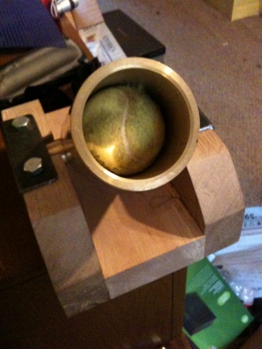

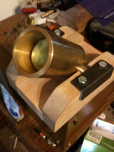

One thing that I've often wondered about is compression of tennis balls.
In my mind's eye, I see the ball being distorted by the force of the charge behind it, and being rubber, deforming enough to expand and grip the sides of the barrel, causing a pressure spike.
Is this just a lack of understanding on my part, or could this be something to take into consideration when designing a tennis ball mortar?

 For me I like thicker walls.  Light charges and tennis balls would be my preference.  Aaaaand..... regular micrometer measurements of the barrel. Just my 2 cents.
 James,
 We've had more than one discussion here about a projectile/wad becomming a bore obstruction so yes, it is something to consider.
 One item that's been said should never be used for a wad over powder for a blank is wet newpaper, as it can compress upon firing and hold tight in the bore.
 I wouldn't think that a hollow tennis ball could present much of a problem. Even if it stuck for an instant it should collapse and blow out without much extra force required. I've shot some with hefty charges that partially stripped the cover off.

  Hi I have shot tennis balls out of my mortar with a heavy powder charge and they blow apart
when they exit the bore but I have a heavy brass mortar #250 lbs. and I have filled them with
bird shot and had good luck for several shots before they came apart weight about 1-1/4 lbs.
then I tried plaster Paris and that works well. but now I just use dog balls from the dollar store.
 ;D Quaker
