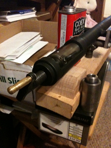

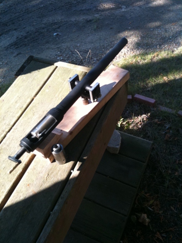

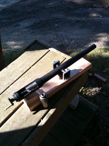

Well, as it is hunting season here and my test range is also my hunting ground, no test fire yet, and I forgot the powder can, but here are some photos of my latest. Interchangable breech in .50 cal. Down ad dirty swivel mount is for testing only, will be making something much better soon.
Short chamber installed, 3.25 inches long
Long,4.25" breech installed.
Going to do some volume calculations and work up to a max load, will post when I have video....

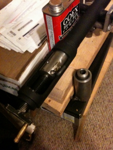

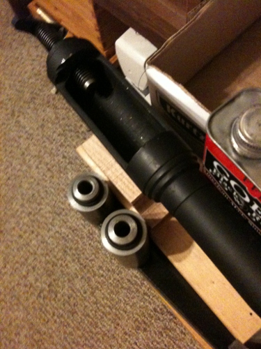

As requested
Long Chamber installed
Open chamber

SHOULD be fairly accurate, drilled to 31/64th then reemed to 1/2 inch, full inches.

Can I assume that there is a matching taper on the end of the barrel to match the taper on the end ofthe powder chamber?

The powder chamber is tapered to 118 degrees, same as the drill but I used to drill the 1" recess.
