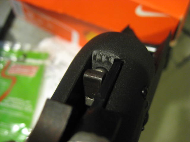

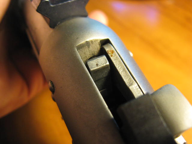

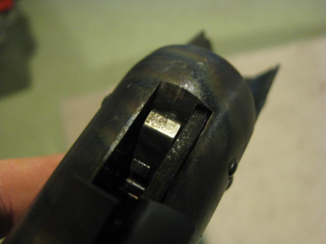

Anyhow while waiting I noticed something odd, I have the USH and 2 sidekicks.
when cocked, the t-bar on the sidekicks comes about 1/8" obove the top of the firing pin, on the USH the top of the t-bar is about 1/16" below the top of the pin, see pics
is there that much slop in the manufacture of the parts?
Sidekick1
Sidekick2
USH
Nicholas Andraka
REO Services
Serving Maryland since 1993

Re: FTF on lightened trigger
« Reply #10 on: September 30, 2011, 06:40:19 PM »
Good pics!
This is what Im talking about when I addressed the Lifter/Striker (T-bar) being either held high enough by the Trigger Extension, and/or the Striker portion of the assembly being 'too short' and with too much chamfer where it contacts the Firing Pin.
You can easily see now what I meant by the 'watermelon seed' squeeze out of the Striker when the hammer hits it and driving the assembly under the F-pin, resulting in light strikes/FTF.

If you look on Numrich Site at the t-bars, my 2 sidekick t-bars look like what they call "Original" and the USH t-bar looks like what they call "replacement"
Hmmm?  When did they change over ? the original has the 45e'ed back and appears longer.
anyone else have the "rounded" top t-bar on their gun, as opposed to the 45'ed back ones ?
Wonder if the "replacement" is even an H&R part ?? maybe my smith screwed it up and put the "replacement" in ??

No same gun,, more I examine it,, looks like someone put an aftermarket Striker/lifter assem in there.
Headed out to local gun shop to see what "other" factory USH have for strikers.
The striker on my USH is just to short, no way around it.

« Reply #15 on: October 01, 2011, 05:38:53 AM »
The last one looks like a new style unit to me.
Let me go look at some of mine.. I don't have many "new" units. But I'll look for you anyhow...
You DID do right going to a profesional. HE is the one who may have made the errors, not you.
