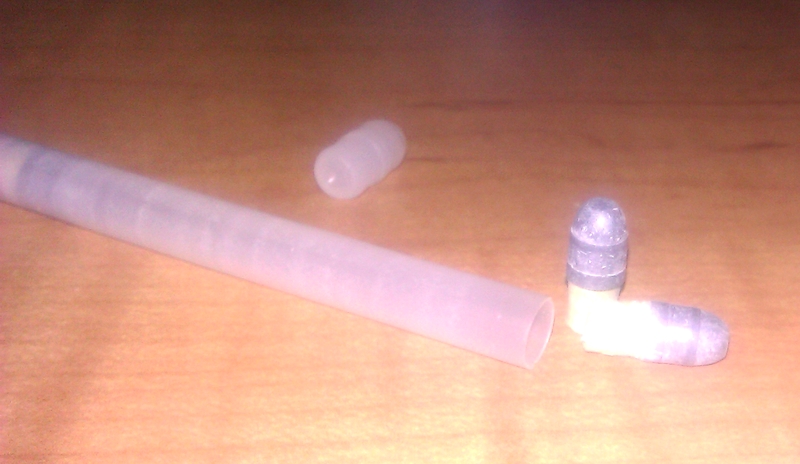

Well one quick update so far.  Cornbelt a.k.a. Tim was kind enough to send me something I'd never heard of in the form of Daisy VL .22 caseless ammo.  Apparently, this was used in a firearm Daisy designed in the 60's and fired .22 cal bullets without a case using compressed air heat to set off the charge.  Kind of a neat concept.  Anyway, the idea died and here's a picture of some of this now defunct ammo:
Tim apparently bought some mistakenly years ago and thought it might work in my .22 Marlin Muzzle loader and work it did!  It worked perfectly with no misfires or other issues.  Unfortunately, I still haven't finished my thumb release bolt spring, so I am still dropping the hammer, so to speak, in a manual manner and tonight I had only 20 or so minutes when I finally made it to the range and got set up.  Thus, I have only one group that wasn't that stellar.  The wind was about 25 mph today also, and kept spinning my target, so sometimes, the bullets were slicing into it at about 45 to 60 degrees.  Ah well, I was still pretty happy to see how nicely they loaded and all.  Thinking later, I might wet some ffffg powder with a water & dextrose binder and try making some little charges like this in a board with a dowel rod to push out the finished caseless round.  Thanks so much for contributing to my research Tim, was a blast to shoot em.  I will try the other pellets also at some point, but didn't have time today.  8(  Anyway, here's the target from 25 yards:
