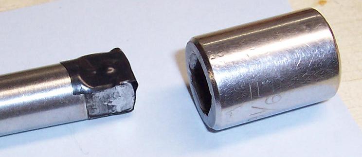

Wrap a strip of electrical tape over the end of the extension and jam into the socket. Hopefully it will provide enough tightening to the socket to get your socket out of the tight spot.

A piece of shop rag between the socket and the extension makes for a pretty secure connection between the two that doesn't have to be permanent.
