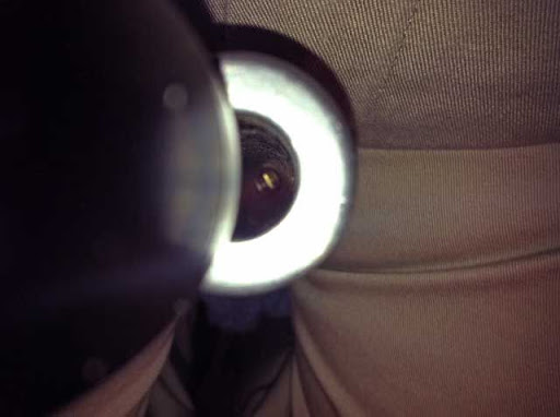

Any thoughts on how to look down the barrel and see the bottom of the bore? I would swear I see what looks like 2 small black geared wheels down there with a gap between them. I know that is unlikely but that's what it looks like to me.

Here are the best photos I could take looking down the barrel. What the heck is that down there?

Maybe someone's child decided to "load" it if so you'll have to fish them out.... just for the heck of it have you tried unscrewing sections? it's possible it's screwed together... also does it have a touch hole? And as others have said trunnions should be around 1"

Is it possible that you are seeing the threaded ends of the trunions down there protruding into the bore? Measure length to the "gears" then measure muzzle to trunnion length.

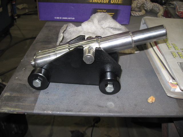

The bore obstruction was a pair of barrettes , here is what it looks like now . Ed
Re: Mystery barrel?
« Reply #14 on: September 22, 2011, 03:12:21 PM »
I like those trunnions much better.
Re: Mystery barrel?
« Reply #15 on: September 22, 2011, 03:43:50 PM »
Looks much better! Shall you be proofing it?
