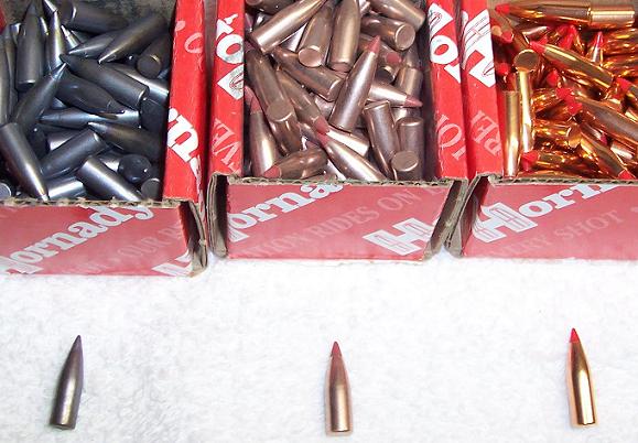

I ran some of mine in my Lyman 600 with Lyman Treated Walnut media to get the Moly off. It does take almost all the Moly off of the bullets, leaving just a bit of a gray tint.
Here's a picture of before and after about 2 hours in the vib. tumbler. The ones on the right are new V-Max without Moly, just for comparison.
I keep the media seperated from the good stuff,as it does leave the Moly residue on the walnut media.
Bill
