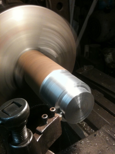

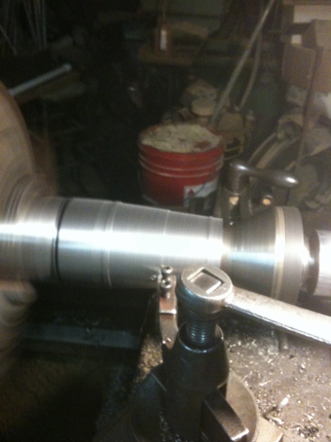

Thanks for all the diagrams, they will surely come in handy. Thought I would document this one from start to finish, so here goes.
First pass, truing the end

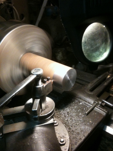

Starting to take down the breach area.
Oh yeah, my friend's 1934 Lima lathe.

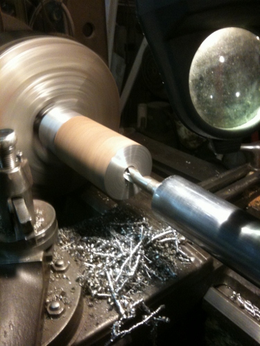

Starting to drill.

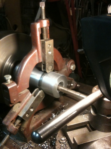

Surface prep for steady rest and boring.
And starting to bore. As of end of the day, bore is at 1.6 inches, a bit more to go for golf ball dimension of 1.728-1.730. Powder chamber is 1"x1 1/4".

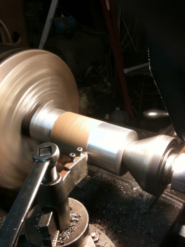

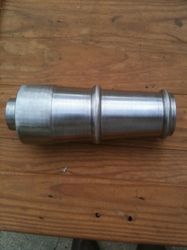

Day two of the Carronade..
First off, I misidentified the lathe yesterday, the gear box is a Lima
The lathe is a Hendy
Starting to define the barrel
End of day results

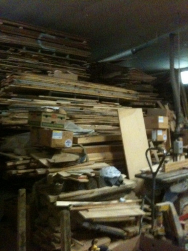

Where can I find some wood for the slider and base?
Yes, my friend has a few hundred thousand board feet of lumber.

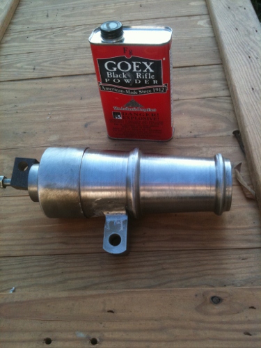

Forgot to take the camera with me today, so just an end of day photo. Bottom lug installed and back starting to take shape.

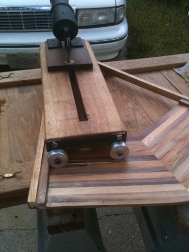

Posted this in the "Making a new carriage look old" thread too.
Day 2 of the display base build, that bottom piece is the 8/4 oak, mortised so I could use a single piece. The part under the carronade itself that slides, is 3/4 walnut. First coat of tong oil completed on both

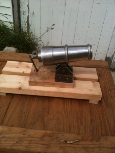

« Reply #20 on: September 20, 2011, 07:58:15 AM »

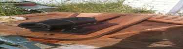

Outside of replacing the aluminum wheels with brass when I get some more brass round stock, I think this is done.
It is on a firing deck that limits it to a 45 degree of movement
Slider is American black walnut, the pivoting base oak, and the shooting base multiple woods.
Aluminum wheels will be replaces with brass.
