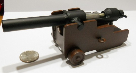

I just finished a 25 caliber breechloading naval gun. [I can't get the image link to work.]

That's a mighty good looking little cannon that you've built, Dom. Are there any plans to make something similar in a larger bore? Just wondering.

I made this in my spare time.  I'm thinking of a 36 and 50 caliber version.  Maybe with a field carriage.

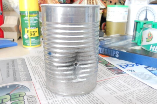

It's a hoot to shoot.  I had fun with it earlier today.  I attached a video link and a photo of a steel can I shot at from 3 feet.  The load I used was approx 8 grains of 4f with a 1/4" steel Daisy slingshot ball.  I'll make a better quality video of it at a later date.

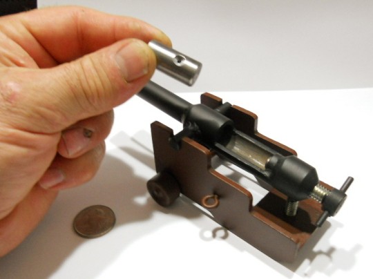

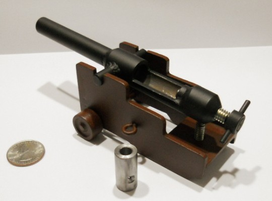

    I like it, Dom.  What aligns the chamber piece axis and the axis of the bore.  Is it a close tolerance fit of the chamber O.D. and the tube I.D. in the insertion area?  Is the bore the same dia. as the chamber I.D.?
    As far as rifled bores and projectiles go, I think you would have a cartwheeling cannon in any bore size over .25 cal. if you drive the bullet fast enough for stabilization.  You would put DD's early experiments with his scale 42 Pdr. to shame!  The cannon does not look real heavy.  As a smoothbore, I bet it would be top notch!

The OD of the chamber piece fits snug into the tube and the rear of the barrel is chamfered slightly.  There is no powder chamber in this cannon.  If I made a rifled breech cannon, I guess it would be better as a swivel or sledge mount, yes?Here is a video of the first one I built several years ago for El caz.  It has a different shape chamber piece that I found unnecessary.  The 1/4" protrusion of the OD tube is all that is required for a smoothbore.  Rifling may be a different situation.
