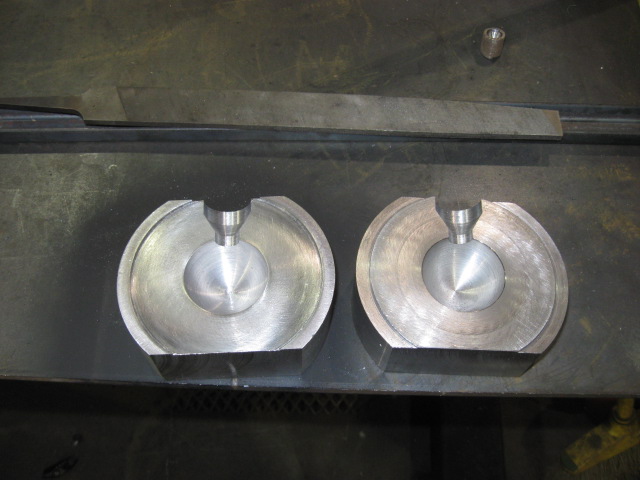

« Reply #11 on: July 07, 2011, 01:12:08 PM »
Ed how much are you going to get for these moulds?

« Reply #12 on: July 07, 2011, 02:43:02 PM »
Ed,
And maybe a pic or two??

« Reply #13 on: July 07, 2011, 04:27:18 PM »
Does this help ?

« Reply #14 on: July 07, 2011, 04:29:45 PM »
I am not sure what just happened . I have posted quite a few pictures but it didn't work the same this time . Ed

« Reply #15 on: July 07, 2011, 04:34:05 PM »
Are these molds aluminum or steel?  Estimated price?

« Reply #16 on: July 07, 2011, 04:37:21 PM »
Steel!!!!! Yipeee!!!

« Reply #17 on: July 08, 2011, 03:53:51 PM »
The price is $105  shipping included .

Ed:
Are you going to offer a pivot mechanism with handles?  Anyone out there interested in doing that?  With a pivoting closure mechanism, handles and a ball bungee one could really go "balls out" (sorry... couldn't resist that pun).  :)
