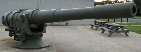

  I have the book,  " NAVAL GUNS" 500 years of ship and coastal artillery, by Hans Mehl.  On page 85, it shows a what looks to be a pivot gun.  It is a 6" 40 caliber that was mounted on the deck of the USS Maine.  There is also a 7" ship gun on page 88 but it is a later version. This 7" gun looks very close to the earlier 6 inch gun from the late 1890's that is at Fort Miles. [photo below]   Some of these naval ship guns from the Spanish American War were used as coastal guns during World War One & Two.

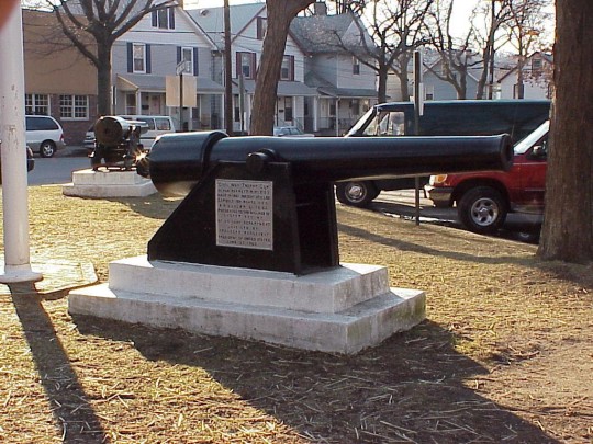

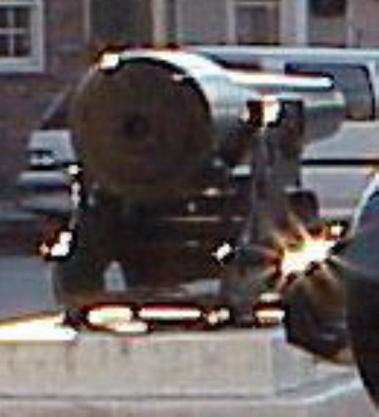

There is a Parrott breech loader conversion with iron Marsilly carriage on display somewhere.  Photos below.    Does anyone know where this is located?  Looks like a town center?
