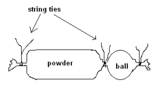

Personally, I never patch a ball in a smoothbore.  I know others do. I don't think it's a big issue either way.  I load the same way the Revolutionary War minuteman loaded a musket.  He carried pre-prepared paper cartridges that contained the ball and the powder.   1. He tore off the round lead ball to open the cartridge and used some cartridge powder to prime the vent and closed the frizzen.  2. Pour the powder from the cartridge into the bore.  3. Drop in the ball.  4. Insert the paper cartridge after the ball.  5. Use rammer to seat the charge.  Here's a sketch of the cartridge.

What kind of paper do you use for the cartridges?
Offline dominick
  • Trade Count: (21)
  • Posts: 1367
Re: Krupp Cheroot Cane
« Reply #42 on: June 29, 2011, 03:51:13 PM »
I'm not sure what they used back then.  I use newspaper.
