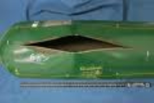

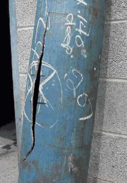

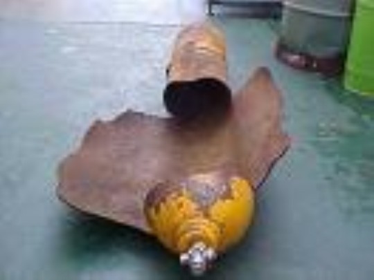

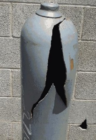

I've never been a fan of using gas cylinders for mortars or cannons.  There have been pressure tests conducted with black powder that resulted in extremely high PSI numbers, much higher than these cylinders were designed for.  They have a tendacy to fail at 2200 PSI or less. [Photos below.]   I can't imagine what one would look like with failure at 22,000 PSI.   I don't think it matters if it's only pressurized for a fraction of a second or that the projectile is only a tennis ball.  Thicker cannon barrels have failed with disasterous results under these same circumstances with only a salute charge.
Photo credit:  Various internet sources.
