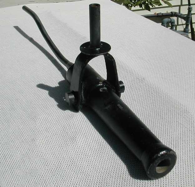

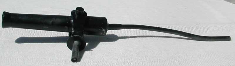

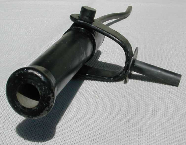

That evilbay swivel is a bit funky  :o
Trunnions too far back... almost looks like they cut the back off and rebreached it.....
very strange.

is it just me or are the trunnions on that way too high?
Re: Is this a deal?
« Reply #4 on: May 26, 2011, 02:54:36 PM »
Looks like the barrel is mounted upside down.  Maybe the vent was drilled on the wrong side.

The swivel mount is not removable.  Looks like it was built that way.

OK, so you've noticed some minor flaws in the design of this swivel gun, but there were also other pics that show some other blemishes on this barrel. The cascabel, which is just a hollow cone meant to hold the tiller seems like it was added on after the tube was cast, and it's not perpendicular to the breech face, it's on a crooked angle. In a close up pic of the surface of the tube it appears to be wavy not smooth (this can be seen a little in the last pic on the underside of the tube in front of the reinforce).
Seriously, it's not what can be seen that really bothers me about this cannon (that's only a warning sign), it's what can't be seen that's scary. If the maker of this 'murderer' has the exterior looking like this, I would think one would be wise to wonder what the liner is made from, and how the breech plug is attached. All I know is that I would never stand behind this gun holding the tiller in one hand, while firing the gun with a linstock held in the other.
