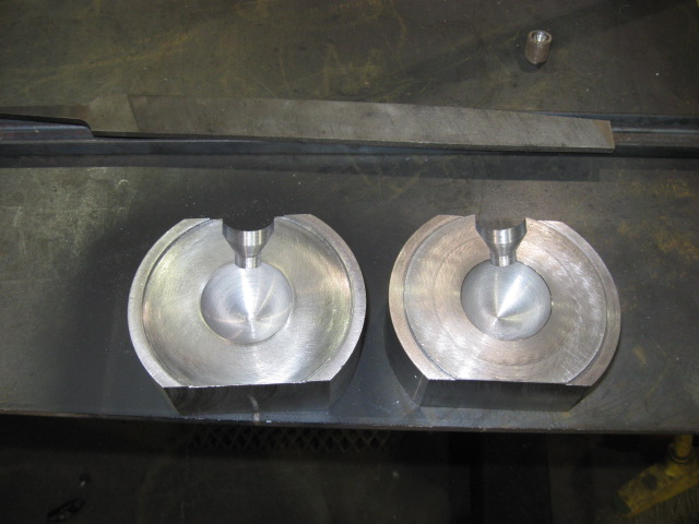

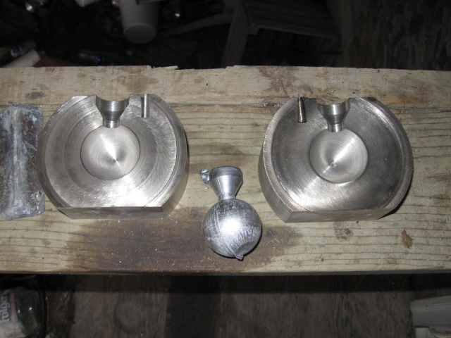

Here is the prototype GB mold . Made from 4.5" HRS
Cast a lead ball today to check my dimensions
Had to add a locator pin.
I always get that little flash at the bottom . All dimensions check + - .005"
