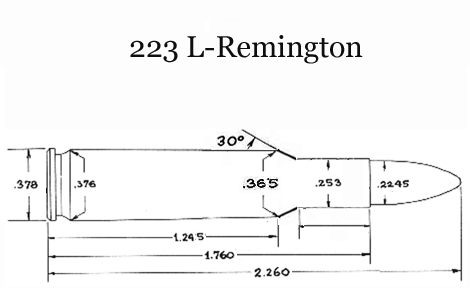

Shane and I have been kicking around modifying the 221 FB and 223 Rem cases to BR specs after the 223 Short is done.
I just suggested to Shane that we do a Bench Rest makeover of the 223 Rem, cheap brass and easy case forming.
If we trim the case to 1.52" like the 22BR/22PPC, change the shoulder angle from 25o to 30o like the BR/PPC, and change the place where the shoulder begins (1.075 from base) like BR/PPC, the result is a neck length of .270 by chance, which can be considered a medium neck length for the caliber. We also do not care about the shoulder height, it is about .175.
It will literally look like a small brother of the 22BR/22PPC and look very similar and be a tad smaller in diameter to the 5.45x39, but using a standard .224 bullet.
OK now I am done.
