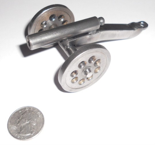

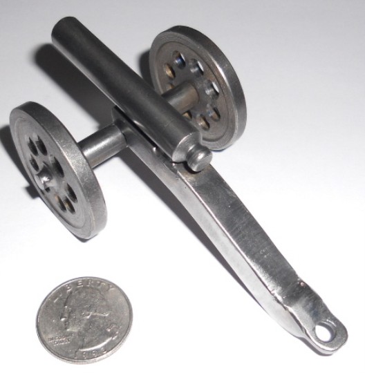

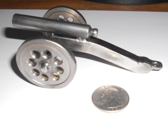

My first attempt.  A little large for a key chain.  All steel.   The 1-1/2" diameter wheels turn and are not wobbly. It has a  9/64" bore [.140"] that will fire a 1/8" steel ball bearing.  The bore on this cannon is the same diameter as the vent size on many larger cannons.  I still have to drill the vent.  It will be 1/32" [.031"]  My next attempt will be a smaller one with 1" or 1-1/4" diameter wheels. I'm exploring the possibility of cheeks, trunnions and an elevation screw.  :-\  My goal is a functional key chain field cannon.

 I like it! ;)
Re: The Quest To Build The World's Smallest Field Cannon
« Reply #2 on: June 04, 2011, 12:09:09 PM »
     I like the concept a lot, Dom.  Are you thinking about including an "Atomic Annie" on a functional sliding upper carriage in your collection of key chain cannon?   ;D ;D
Press on, gotta do a teenie-tiny elevation screw!
Tracy
« Reply #3 on: June 04, 2011, 12:57:20 PM »
"..Atomic Annie.."?  "..functional sliding upper carriage.."?  Ah, you mean Barbette carriage.  Hey now that's a thought!
Worlds smallest 100 pound Seacoast Parrott Gun. I like that!  Great idea!  ;D
