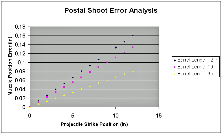

How far does the muzzle have to be from the correct sight line to cause a given strike error on the target?  How does barrel length impact the error?  The attached graph provides the answers to these questions using the postal shoot rules.  Hope this helps those participating on this years postal shoot.

I got my head around this.
You have the rear sighting plane and the  front sighting plane.  The difference between front sighting plane and rear sighting plane is called the sight radius.  If you have a 12 sight radius  and your shot strikes   9 in high you need to lower the front sighting plane .012 inches to hit center.
Or you can raise the rear sight plane .012 inches for the same effect.
Is that correct?
Re: Postal Shoot Error
« Reply #2 on: May 19, 2011, 10:03:52 AM »
must be so

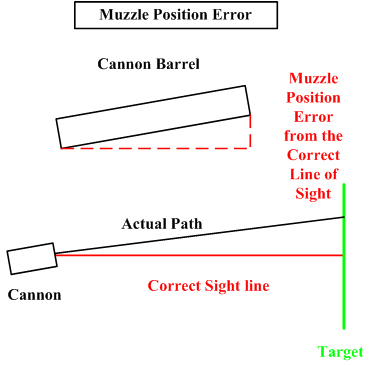

Maybe this picture will explain the graph.  Think of it as looking down on the cannon.  If I am off by blank (muzzle error) inches from the correct sight line what effect does that have on the point that the projectile stikes the target.
That is of course way we have sights on guns.  It is remarkable that the eye can align a short barrel as well as we do.
