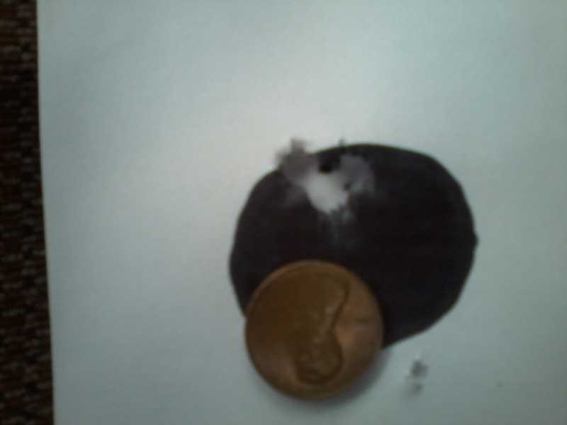

I have had one for several years now.  Mine is a 1-12 twist and i think the newer ones are a 1-9 twist.  I actually ended up cutting the barrel down to 18" since i wanted more of an all around gun for walking and longer range.  its my go to rifle for everything but deer and turkey.  I havent tried anything over 55gr bullets but im sure you could get great results out of heavy match bullets in yours.  I reload using Hornady 55gr spsx bullets, 25 grains of H4895 and Federal GMM primers.  This 3 shot group was at 100 yds.
