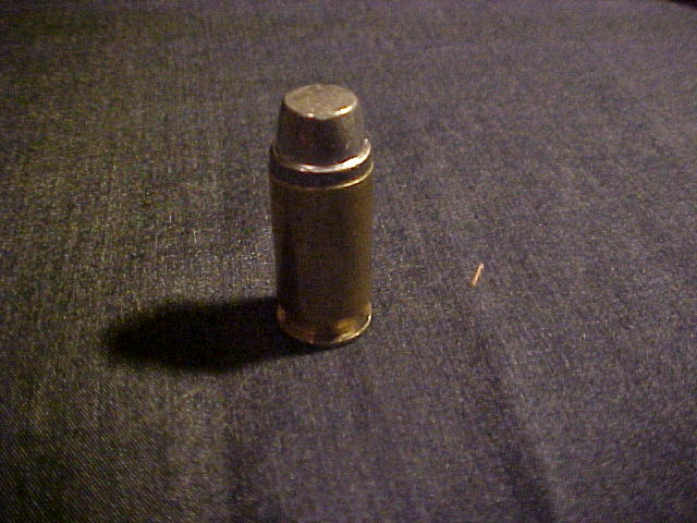

« Reply #5 on: April 03, 2011, 06:17:24 AM »
Here's a snap of a 255gr LSWC loaded in .45 ACP. Haven't shot anything but steel with this load, but it puts it down with authority.
And functions in all my fullsize 1911s.
