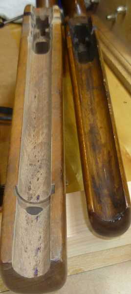

I've never posted pics, or taken them with this camera, hope it works.
60 yrs. ago I broke the wrist of this stock.https://www.gboreloaded.com/mhp/images/Wblaught/1000014.jpg
30 yrs. ago I glued it back together(2part epoxy). 6 yrs. ago the glue failed.
5 yrs. ago I bought a stock from Numrich that was an 80% inlet. https://www.gboreloaded.com/mhp/images/Wblaught/1000013.jpg

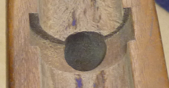

I finished the inletting and the action fits fine. But , along with the bigger size, the stock has features I can't figure out.https://www.gboreloaded.com/mhp/images/Wblaught/1000010.jpg This groove is on the inside of the forearm.https://www.gboreloaded.com/mhp/images/Wblaught/1000011.jpg This groove is on the outside of the forearm. I feel I can cut down the outside of the new stock and fill the groove on the outside of the forearm and it will work fine. All pics of Model 265's I've seen on the internet have small stocks like my original. I would like to know what kind of stock the replacement is, or any other info I can find about this rifle. Thanks for any Help.

I am not familiar with your rifle but the last picture with the inletting may of been some thing that was for an attachment like a bipod or something else they may of been using in those days for Target shooting. Just a guess tho. BTW welcome aboard!! Hopfully some one can help ya out. Kurt

That slot in the exterior of the forearm looks suspiciously like the slot on the M65 and 165 H&R's for the cocking lever.  A multi gun stock?

Looks like a small bore target stock of the period c/w inletting for a barrel band and possibly a handstop rail. Take a look online at Rem.513 s and Mossberg 144 s.

gcrank1: I briefly searched for Rem. 513s and the groove in their stocks looks the same as my replacement stock. I've never participated in formal target shooting so I'm not familiar with the hardware. I will research the target stock angle more. Thanks for your help, it is greatly appreciated.
