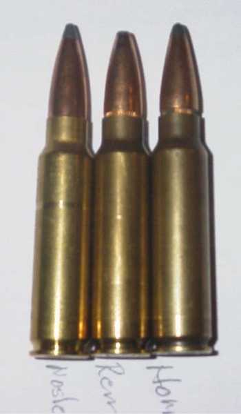

I think the 165-grain bullets are the ideal weight for the 300 Savage when deer hunting.  I have some good 150-grain loads giving slight over a thousand pounds of energy at 400-yards.  The 165-grain bullets launched at a slow 2670 fps product over a 1000 pounds of energy at 600 yards.
Exit hole caused by a 165-grain Nosler PT from my 722 Remington in .300 Savage.  Bullet entered the front of the right shoulder, traveled up the neck and exited on the right side.
