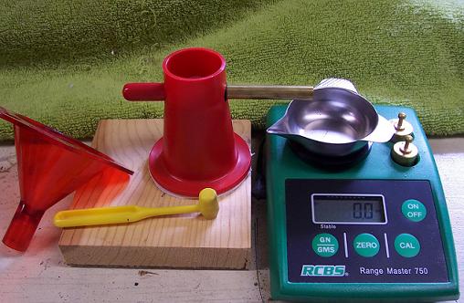

There were two problems that I encountered with the Hornady trickler. One, it sat too low to use with the Rangemaster 750 and two, it is so light weight that it required two hands to use (probably the same as you).  I stuffed about 8 oz. of lead inside the hollow base and secured it to a piece of wood to gain the height needed for the scale. I added some non-skid material on the bottom side of the wood to prevent it from sliding on the bench. The tube turns freely with one hand now.

Looks like Bill has a solution....
